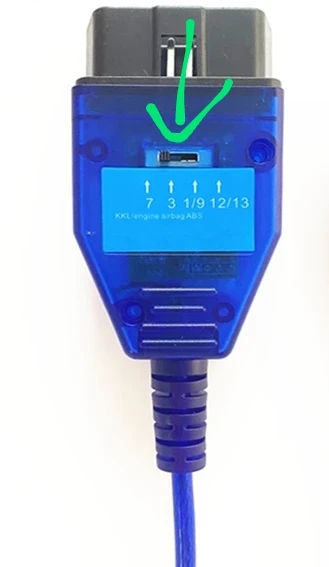

If you get one off these Switched KKL cable
Around a £5
You don't need any adaptors
Plus the free software and Windows laptop
It will connect to the ABS,steering and airbag modules
But it will not connect to anything canbus like the dash
Diagnosed and cleared an airbag code with mine, it's not what I normally use, but it worked fine
