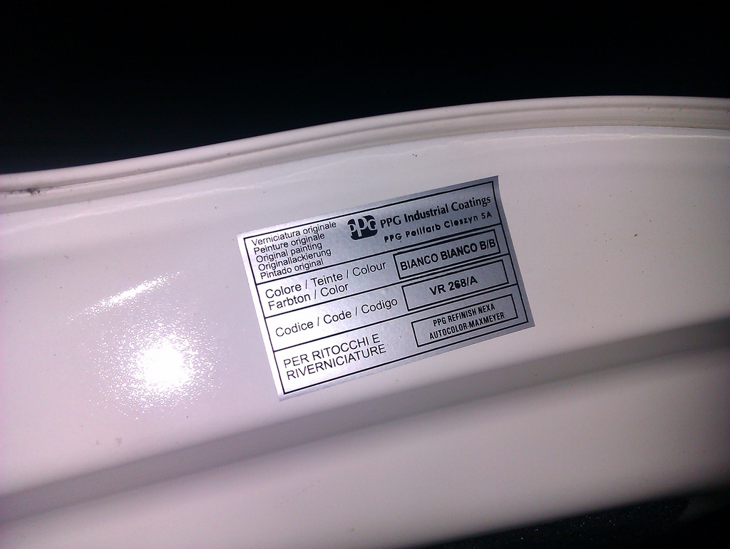

P.S. The paint code is under the bonnet on the 500.
This is off the bonnet of a 2009 500 1.4 Lounge. The silver 'badge' left of the catch has the code. There was nothing on the boot lid. It must have changed on later models.
thats where it is on my Punto evo as you say the YTS kid must have put it in the wrong place on yours :p ;)

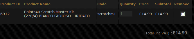

Just to top this thread off re my link to paints for you i have used them a couple of times now Red paint for my old mans focus and this scratch kit for the Punto evo since Fiat dont do a touch up for "easy listening white" :bang:
anyhow ill let the pics do the talking...
you get the Paint,
Really thin clear coat (which kind of melts the colour coat and blends it in you really need to do one swipe of the paint at a time or it drags thinner repairs)
cleaning solvent
some rather aggressive G3 rubbing compound
coupled with 2 small bits of p2000 wet and dry
a small rubber rubbing block
a bit of microfibre polishing cloth
and 5 double ended painting "spears" think cotton wool buds but very firm cotton with a fine pencil like tip...
Not totally perfect there doesn;t seem to be much in the way of metalic flake compared to the factory paint but i have had that with the Fiat touch up paint in the past and since fiat dont make a touch up stick its my best option i have found today and you get PLENTY of paint for your money
Ive left the photos big so you can have a zoom in for a closer look
