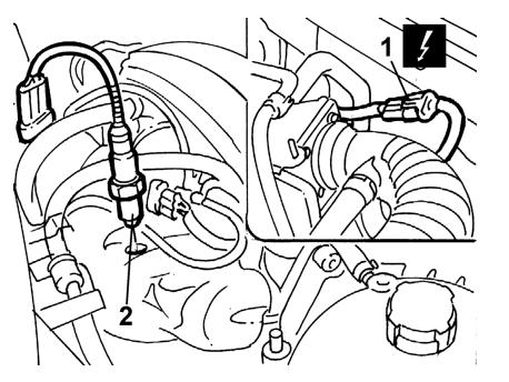

I'd check the O2 sensor for two things at the O2 connector
heater wires-
both the same colour-usually white or grey- -engine off- check for low resistance of less than 20 ohms as it's a plain and simple heater. High resistance means it's broken, the most common failure of O2 sensors

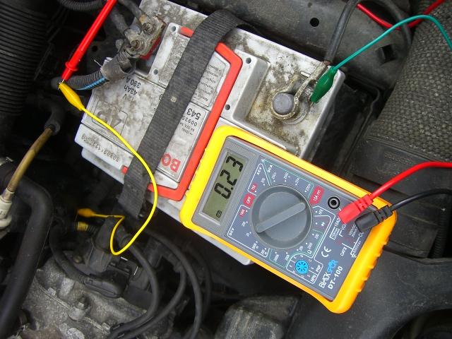

Lambda sensing itself. (shown testing here on a Bravo)
Look in the Stilo guides on electrical component testing and test the lambda voltage output by back probing the connector on warm tickover (the other two wires -often black and red- and you're testing voltage -not resistance this time). It should oscillate between around 0.15v and 0.8v every few seconds
WARNING watch the leads if you're near the rad fan as it may switch on suddenly
