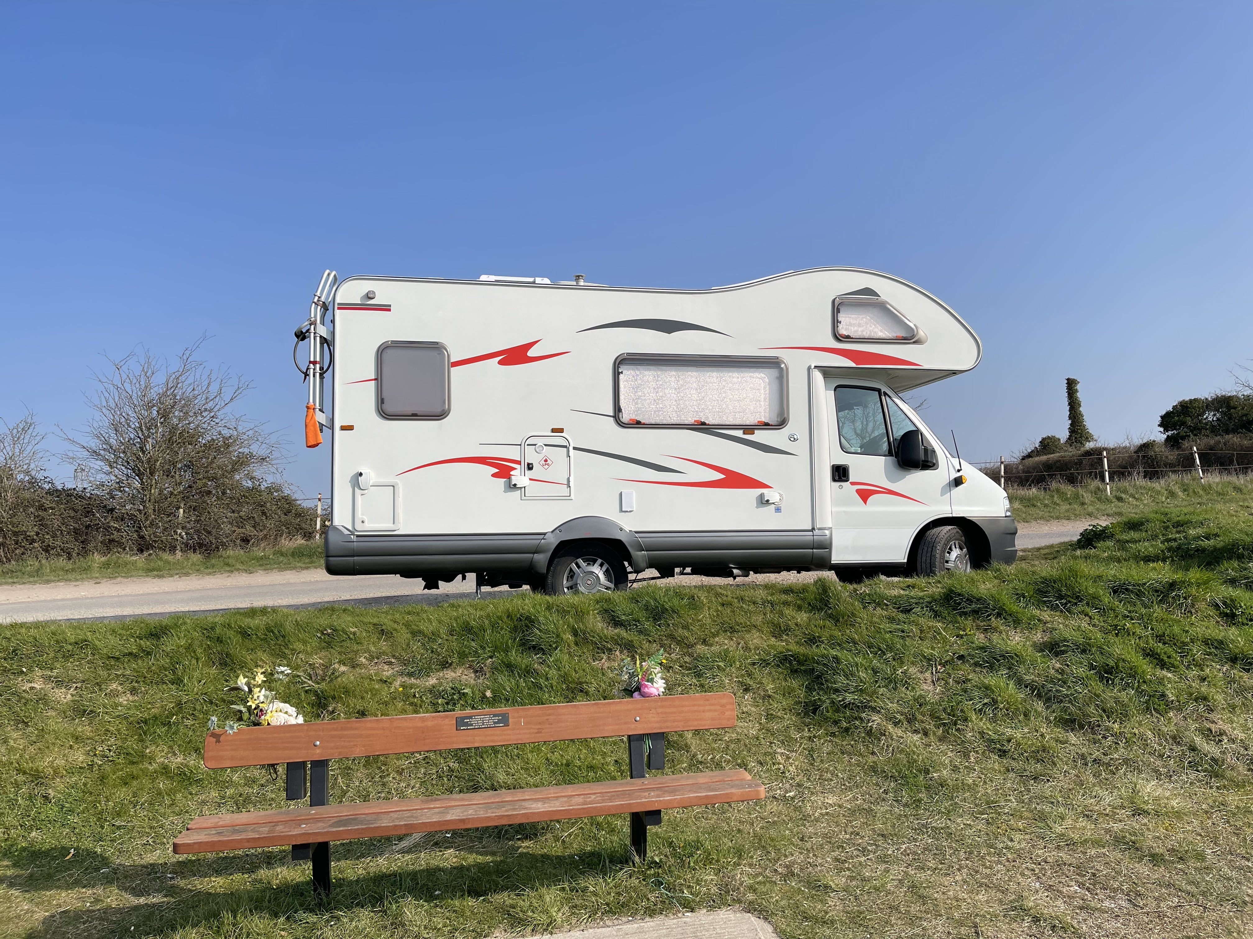

Ducato Our 2003 Fiat Ducato Sundance 600B
At last everything now fully works so now to start a few upgrades
We have had the Fiat ducato Moto for sometime and spent a lot of time and money doing it up, so everything was working and upgraded as much as possible.
A great number of items have been replaced repaired so now everything is fully working.
There are a few more upgraded items we’d like to add, although some would deem our upgrades is unnecessary or too expensive for the age of a vehicle however, we’re not be getting another one so we may as well do what we can with this one
There’s lots of useful upgrades you can do, it’s your van-go for it! 😊👍🏽
Updates started
Here’s the list so far
Well here we go. It’s been somewhat of an adventure since we bought our
Fiat ducato swift Sundance 600B 2003 Moho.
I say adventure we have not been anywhere in it yet.
With a confirmed dvla of just under 19 k mileage .
A lot of jobs that needed doing and some that had to be done others just to put our own stamp on it.
Additions and improvements and essential items.
So all said and done it’s had a bit of a refurb.
We bought it knowing there was a bit to do to it and we were happy to take it on.
It’s not new its paid for and.
I Don’t mind if I get a few scratches or scrapes.
So here’s our list that seemed to go on and on.
Another few weeks. In fact turned out to be 11 weeks in total.
