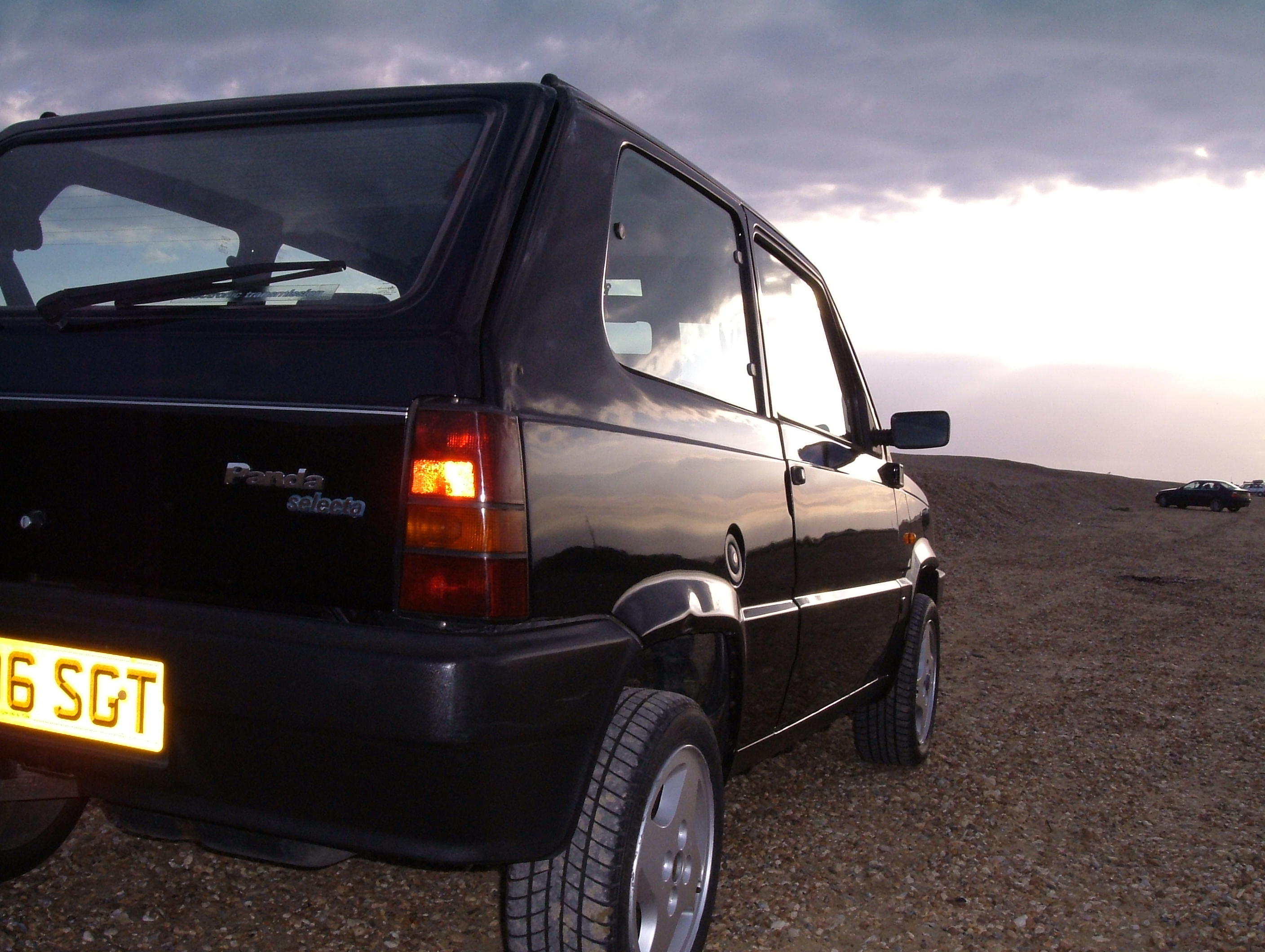

Here is the same wheels we have had on some of the "others"
They have all passed mot's with the wheels on. Never had a problem.
