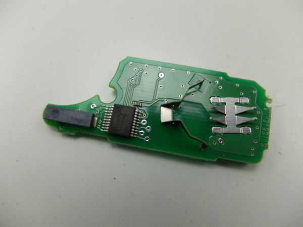

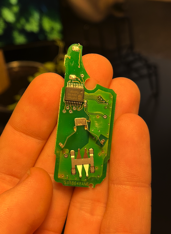

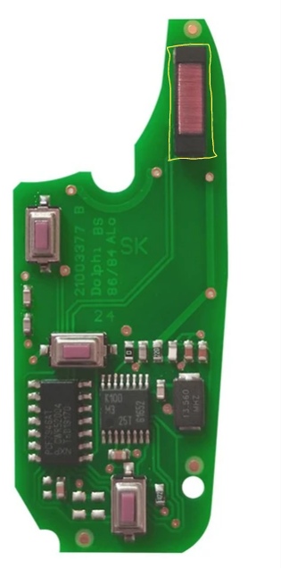

The plot thickens... I had a look in my keyfob (I broke the transponder once, so I was afraid to open it after the relearning a few years ago) Turns out the little coil is missing!! Although it continued working after the relearning (and I guess the last opening of the key)
Very weird stuff... If i find a replacement key somewhere, can I just change out the coil?

Looks like a delphi key fob
Yes should work with one from another similar fob
Looking at the solder splash, it looks like some has been here in the past
Check the legs on the IC nearest some of the legs don't look too good, maybe just fluff
