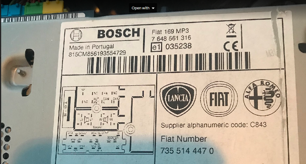

Hi all,
I have a 2009 Panda Pop.
The stock stereo is a Bosch Fiat 169 MP3 with no option for Aux, but I'd like to bodge one in, if possible.
I've seen videos of people doing this with the Blaupunkt version of this stereo, but unfortunately mine lacks the menu option to select Aux, and the pin configuration on the back seems to be different. All pins appear to be fully populated with plugs (apart from the ones that are 'NC').
Would I be able to hook in a 3.5mm stereo cable into the amplifier somehow? If so, which pins would I need to hook in to?
Many thanks,
Richard
