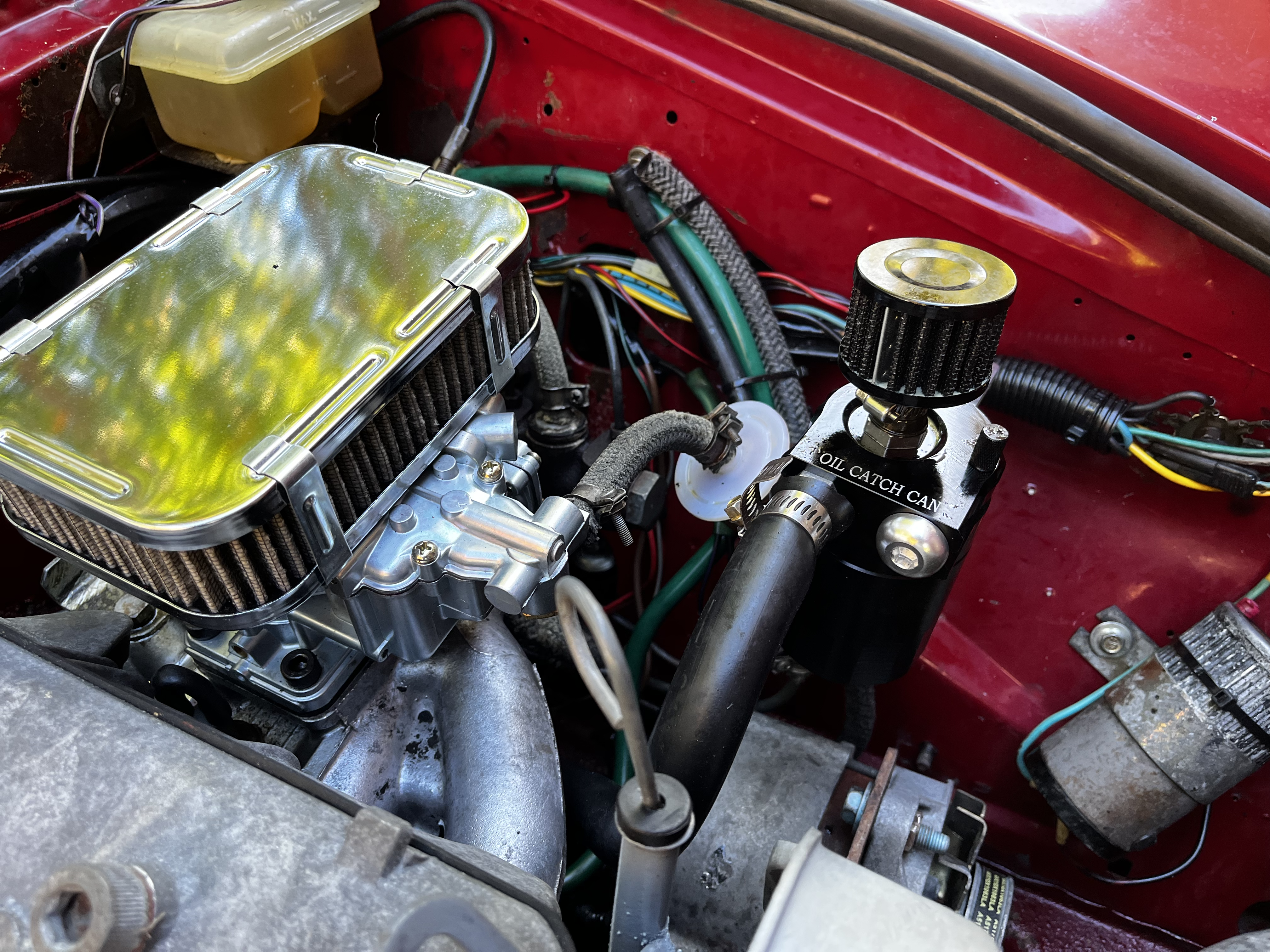

Hello again...and thank you for your suggestions.
I have installed an Oil Catch Can - an interesting and novel device to catch the oil coming from the engine crankcase hose vent - this works well, without any effect on engine performance...please see the photo and I welcome you comments.
Looks like quite a neat solution.:)
