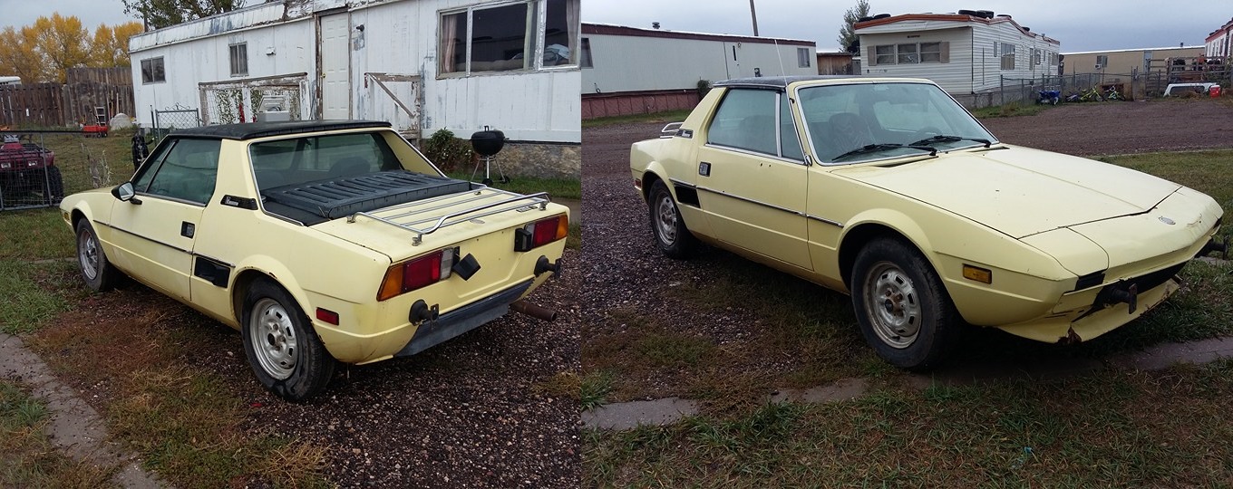

Starting work on our '78 X and wanting to get rid of the old points and condenser so here asking who has experience with what alternatives. It seems to me that for $105 from Vick's going with a whole new dizzy would be the way to go here.
Thanks,
Pyro Chuck
Vicks distributor poor Chinese clone. Go for used Bosch unit or Lumenition conversion. Both very good. Lumenition unit, inexpensive and a fit in your distributor. Need new (electronic ignition) coil for both
