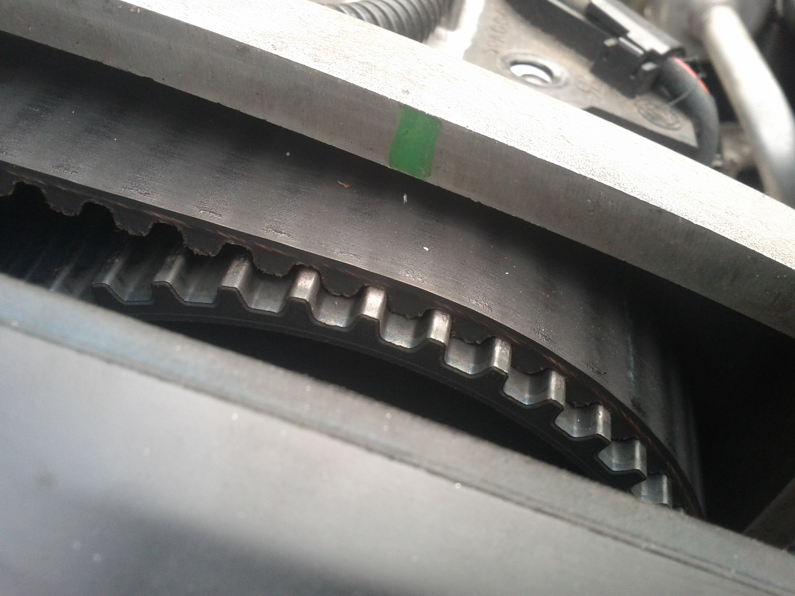

The powerplant, dressed, undressed, the state of the cambelt etc..

Looks as though you need a new timing belt. The teeth don't fit in the pulley (worn belt teeth) and the belt is not in the correct place on the pulley. You can see the marks on the pulley teeth where the previous belt was.
Weird, having shown the picture to a couple of trustworthy people, they said it's a relatively fresh one. And as per the dealers words, all the filters are new, alternator belt is fresh, the oil is crystal clear, the ac blows hard cold due to 500g of new gas...why would he lie about the cambelt?
Well, first of all, if you say that we see traces of a previous belt, than this one must be a replacement. :eek: And at 113.000 genuine kilometers a replacement belt surely has to be a good sign.
I will go to my mechanic as soon as I find some time and discuss it with him.

How do your "trustworthy people" explain the gaps between the belt teeth and the pulley teeth?
How do they explain the belt being in a different position on the pulley than the previous one was?
I wouldn't say the gaps are that bad? There will always be some sort of small gap where the pulley pulls into the teeth under tension and it's only in a different position because its not as wide as the last one. I wouldn't worry about that SchumacherM cruise control is a great add on isn't it :)

I have two oil filters in my garage, one is 3mm taller than the other yet the part numbers match when I cross reference them for my car. The car manufacturer may make theirs to a certain size but it doesn't mean other component companies make theirs to the same standard. This maybe the difference of a quality part and a poor quality aftermarket part but to say he has the "wrong" part fitted is misleading and may make the poor fellow worry unnecessarily :D
When it comes to a simple screw-on filter it's a little different to a crucial part of the engine that prevents from chewing its insides apart :p but I see your point gadge but I would be a little concerned myself about the amount of gear protruding from the belt...perhaps the tension can be loosened just enough to slide the belt out a bit, but as you said it may well have settled for that spot :)
