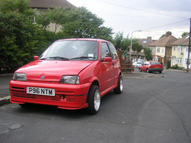

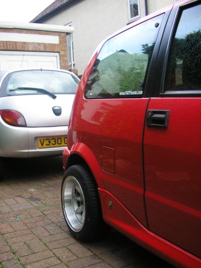

ive been reading through a few sites regarding the MOT tests for wheels and tyres and nowhere does it mention anything about the wheels having to be within the arches.
my minilites come out roughly 1" on the back. does anyone actually know if there are any rules regarding this or if it will be ok? i dont particularily want to be pulled by the police about them but at the moment i cant find anything to say that im not allowed to have them!
minis using the sportspack minilites have the wheels about an inch out of the arches.. even with the sportspack matching arches. they get away with it!
heres a quick piccy anyway
They shouldn't be outside of the wheel arches, but if theres not much in it, it'll probably pass.
EDIT: but they look quite a long way out... perhaps a wider bodykit/ arch extentions are required.
There's nothing on the MOT sites about it but I have spoken to MOT testers about this before and they've said it's a failure if it sticks out at all due to the damage it can cause to the car and pedestrians. Have you a set of normal wheels you can use for the test?
well i would like some wider arches but there arent any off the shelf ones for a cinq so anything i do will have to be custom!
cheers ben! btw, are you any good at moulding things to other things? i have an idea that i would like some sportspack mini arches moulded to some abarth arches for the cinq to make them wider.. would you be able to? ide give it a go myself actually :)
just know ude do a better job :p
but like ive said, there isnt anything in the MOT rules that mentions anything about wheels having to be in the arches.. not a single thing
hmm well im driving it to work tomorrow with em on the back ( cant be bothered to take em off at the moment)..
tbh.. i really dont see how it can cause any danger to pedestrians... shurely if they are walking close enough to get hit by them then they shouldnt be in the road or i shouoldnt be driving on the pavement in the first place
