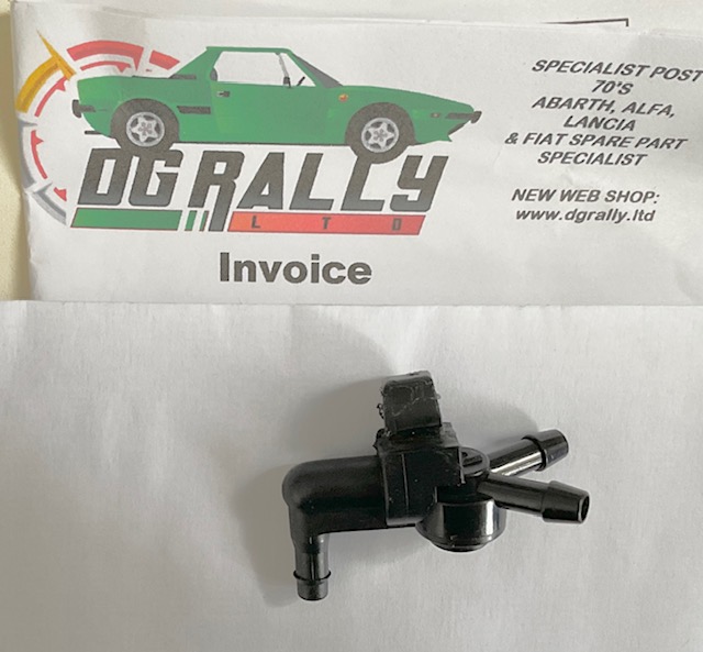

Just like to post a problem I had with Front Screen Washer jets on my Mark 1 High Top Fiat Doblo 2008. Only getting a dribble from them so cleaned them out, still no joy. Motor was working fine. I removed the tube leading from the Screen Wash to the Non- Return valve and screen wash was flowing okay. Eventually worked out that the Windscreen Washer 3-way Jet Valve was blocked/faulty.
I ordered a new one on ebay £8.22 (inc p&p) from DG Rally Ltd, and it arrived next day. Problem solved. Jets are working fine now.
