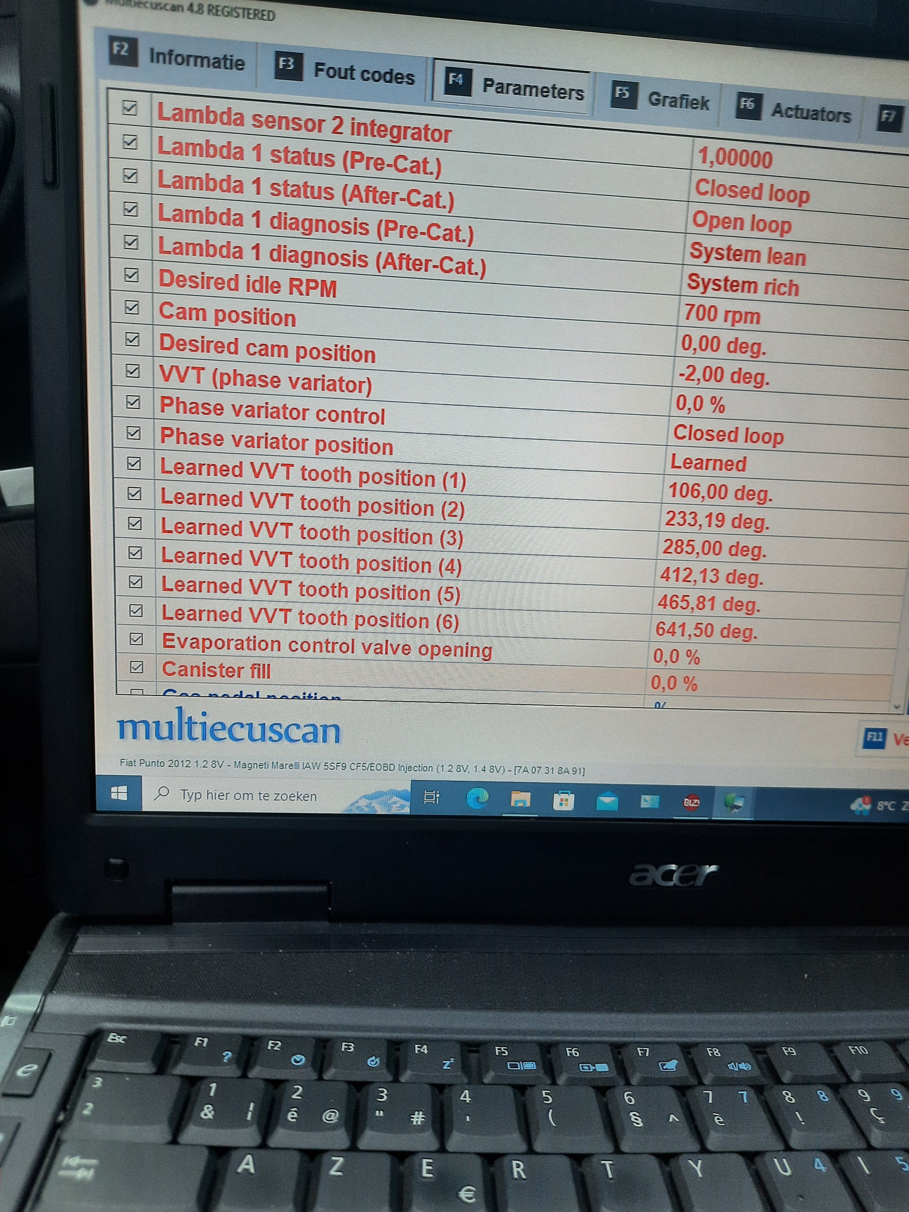

I've a punto 1.2 v8 from 2012. After i went to the garage i got this faults. Changed bougies, bobine and kabels. Now is my question, could it be that the timing belt is one toth wrong. See pictures.

Go back to the garage! Make them fix their screw-up. Timing belt job was done improperly.
Plus, you should do the valve clearance check/adjustment while "you" are there.
By coincidence, the ignition system might be faulty (coil, cables, sparkplugs). Or the fuel (injectors).
