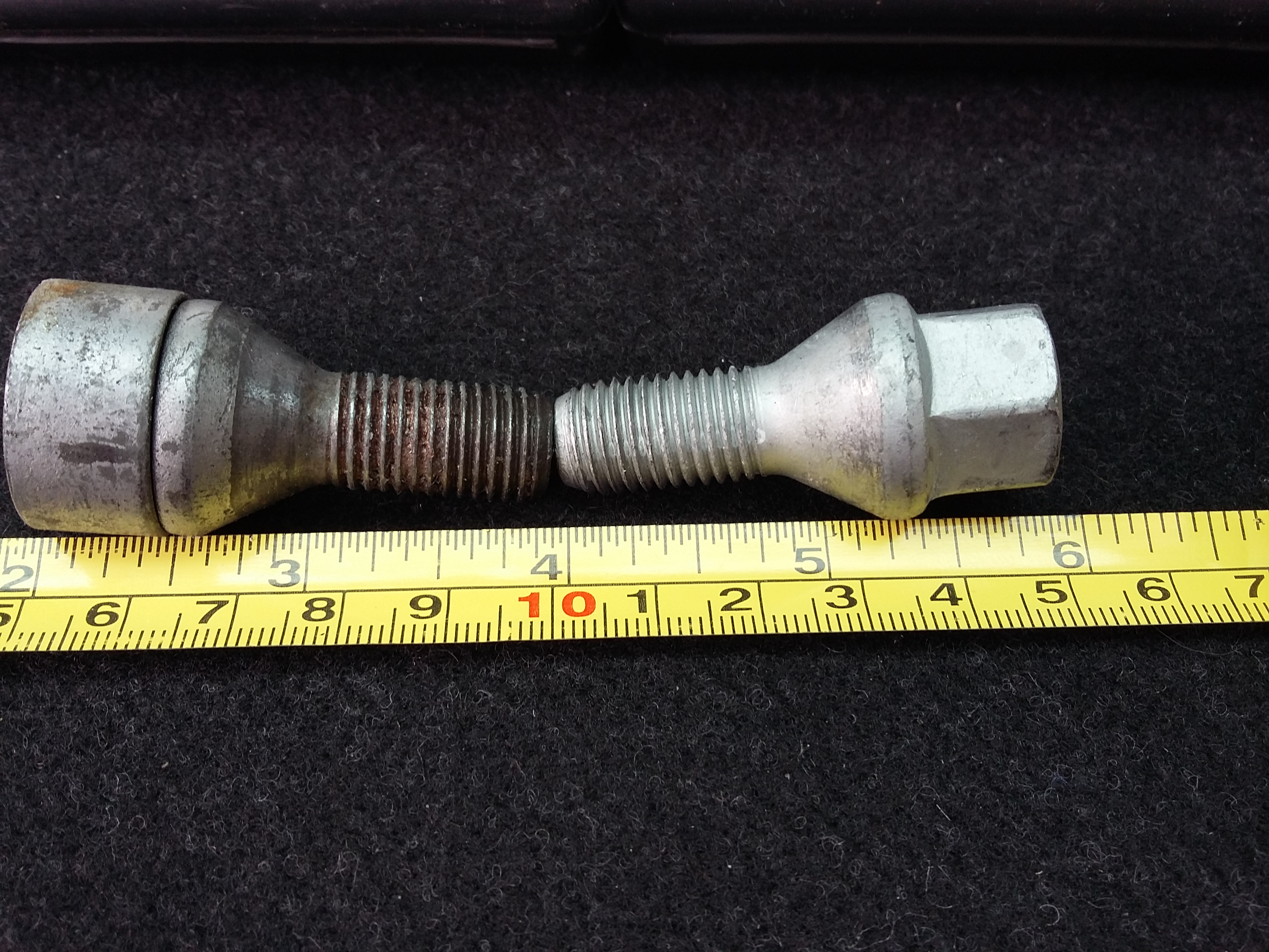

@StatPanton
Your 2 links are for 2 different types of bolt.. The Threads are different
Pretty sure you need M12 x 1.25
Thats the distance between the threads is 1.25
Easiest measured over 10mm = 8 threads
So..
(x 1.5mm pitch thread would be less than 7 threads)
Standard FIAT wheel bolt and FIAT locking bolt pictured
Probably x 1.5 pitch.. Suit panda and 500
