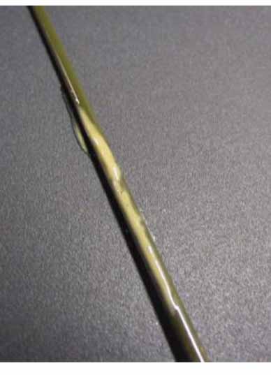

I have just checked the oil on my sons Panda (2006 1.1 active, 68,000 miles) and noticed some mayo on the dip stick, I removed the filler cap and it was covered in the stuff.

how much mayo are we talking about ? photos
a bit is normal, here's my working car

Mayo in the oil filler cap is not a big worry - it just needs a long drive to dry out the engine. Mayo on the dip stick is (very) not good as it suggests the whole oil charge has turned to emulsion. The only cause for that is coolant in oil = head gasket.

without the Photos asked for in Post 6 and post 11 we are diagnose with are hands tied behind are backs but nothing the original poster has said would point me to anything other than a coolant leak which does need sorting before it leads to more problems
