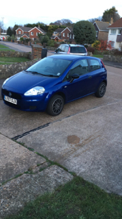

Hello lads, recently upgraded to some 15 inch alloy wheels on 195/50 tyres, coming from 175/65s on steels. I'm due for some new tyres soon and was wondering what the maximum size I could go is as my wheels look fairly small at the moment in my arches and want something a bit bigger, without messing up my speedo. Any help would be appreciated! IMG_0593.JPG
Hello lads, recently upgraded to some 15 inch alloy wheels on 195/50 tyres, coming from 175/65s on steels. I'm due for some new tyres soon and was wondering what the maximum size I could go is as my wheels look fairly small at the moment in my arches and want something a bit bigger, without messing up my speedo. Any help would be appreciated! View attachment 186869
I would imagine you could get some Tjet wheels. 205/45/R17 - could always consider getting your speedo calibrated or you could use a GPS app on your phone. (MOT)
i dont have minimum 5 post for links
these is 195/65 15" winter tyres. i think is best option 195/60 15" . maybe is 195/65 to big for rear tyres when car is full loaded
