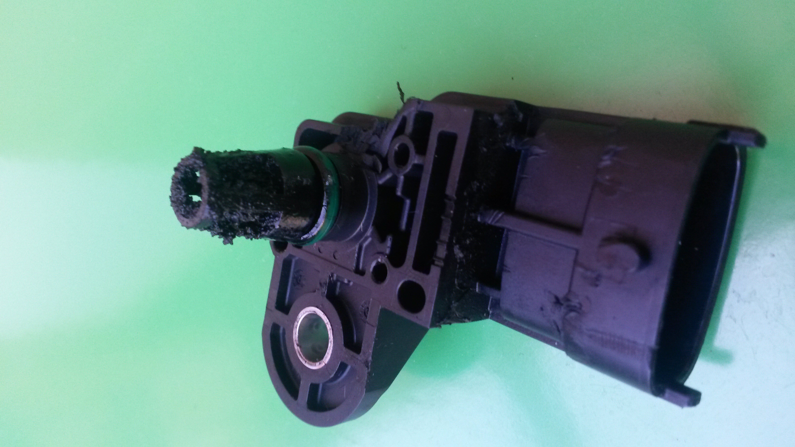

This morning I was changing the MAP sensor in my Fiat bravo II 1.6 due to lack of power. The car was every few days in LIMP mode and connecting the FES I can see that the preasure on the admission was lower than expected.
When I've removed the sensor, it was very dirty, I guess it is due to EGR valve.
I have to say the car is working so well again, and I would say the consumption has dropped too.
Attached a photo with the sensor.
Cheers
