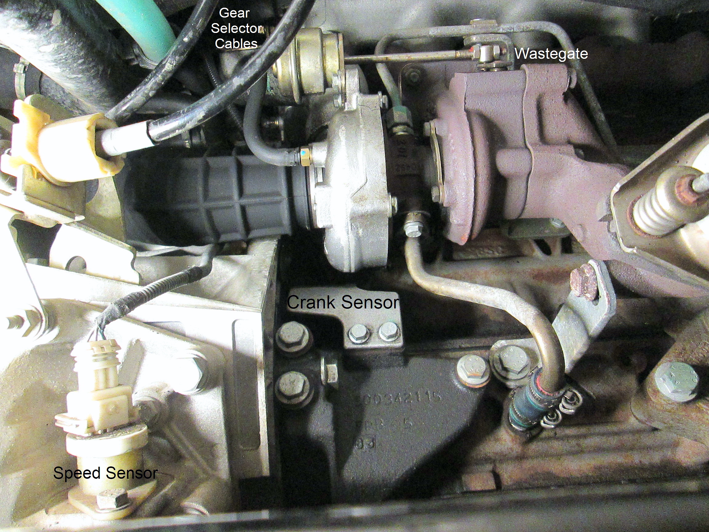

Dose anybody know if the wastegate has to be set up ?, basically it's in same position near end of threads.. if I push it in and out the van appears to run better for while.. just a thought as don't know we're to go now..
If wastegate vacuum controlled it will be worth checking pipes etc. Plus the wastgate actuator if vacuum controlled.
On the basic 2.8jtd, 8140,43s, the wastegate is contolled directly by the boost presure, which it limits to a maximum. With this engine, problems can arise with the linkage between the capsule, and the wastegate failing.
I would not expect the link to move easily under hand pressure.
I think that you need to monitor boost pressure, either directly with a gauge tapped into the capsule feed (see small pipe from turbo compressor in attached photo), or via MES.

Has the vacuum actuator and rubber pipe been tested for leaks, also intercooler and pipes to inlet manifold?
Usually if actuator and pipe it will be permanently down on power, if intercooler side it may be only when full boost required.
Re adjustment from memory with engine off it will be loose and when running the wastegate will be held shut until pressure to strong so waste gate will open slightly to bleed off boost pressure.
When increasing performance on the 2.8 in my boat I shortened the rod which held the waste gate shut longer increasing the boost, first I increased the fuel at the pump so it black smoked then increased boost till no smoke then more fuel etc.
Only to a sensible amount and I used a pressure gauge to measure boost pressure.
Anyway not something needed for road use.;)

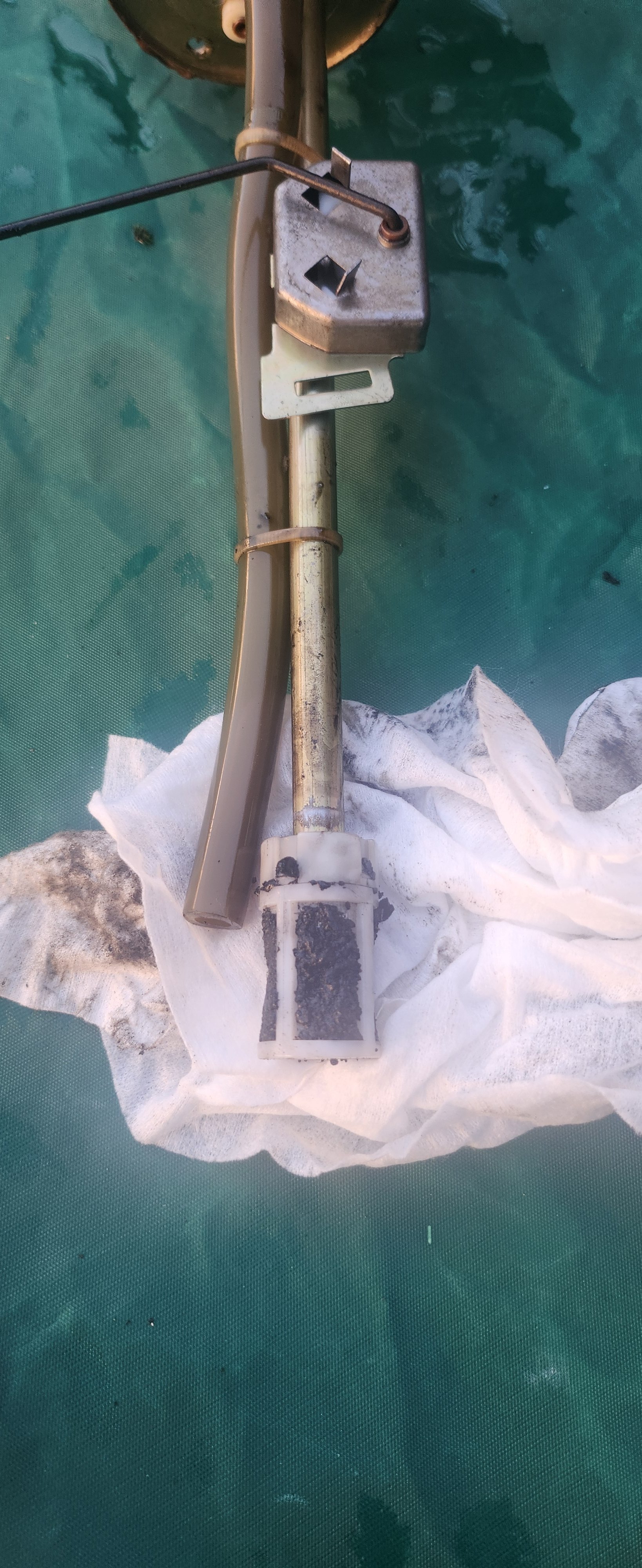

Many thanks everyone for idea's on my long running and expensive issue, however I believe I've sorted it today, I took the fule gauge sender unit out of tank and a small filter on the bottom was blocked with loads of crud, cleaned it up and been for half hour drive, up & down some hills to push it hard.. driving perfect now 🤞,see pic of filter..

That's good news, it may be worth putting some Biocide additive in the fuel tank when you top up in case any bugs in it, they love old diesel.
Now who said this?;) "Someone on another thread recently had a blocked filter gauze on fuel tank pick up in the fuel tank which restricted fuel flow ." :):):)
