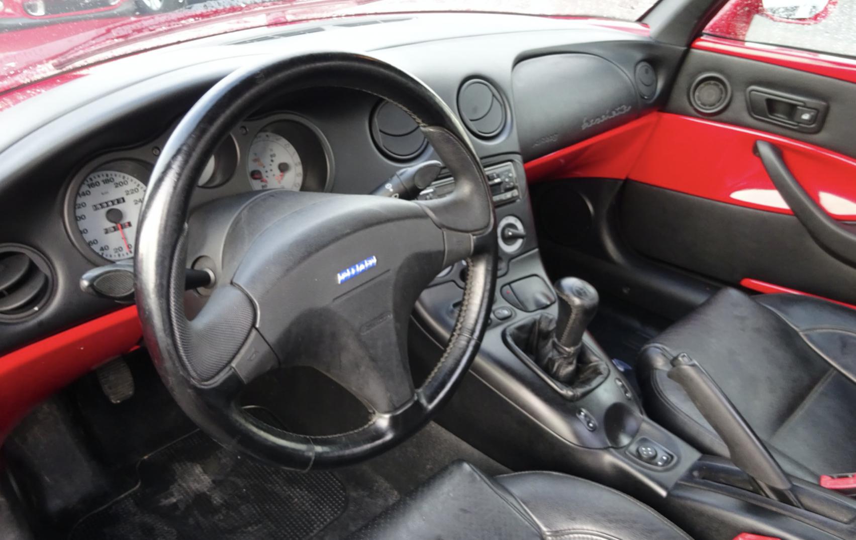

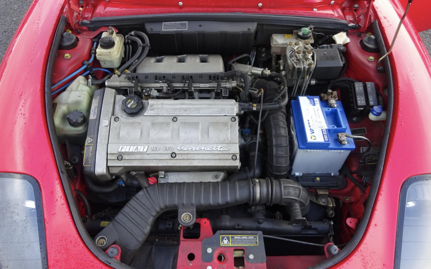

I have decided to buy this one. It is 5,900 CHF, it leaks a bit (needs a new seal for the top), it has a small crack in one front light cover glass, and I will get. it fully inspected soon.
1996, one owner, full papers, all inspections, only 59,000 km so 37,000 miles. New battery and all inspection reports including original purchase receipts since day 1. :)

Sounds good! More money than you might have paid for the other one (around £4600), but that's not unreasonable for a 1-owner car with full history, low mileage and decent bodywork. I see that it has leather seats too. :D Will it come with any kind of mechanical warranty/guarantee from the seller?
