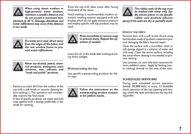

The manual states- "Handwashing is recommended; modern automatic washing systems equipped with soft brushes which do not apply excessive pressure and employ specific soft top products may be used".

Having similar probs with my 500c recently. Bought her 4 months ago and she was fine up to about 3 weeks ago, until I washed her with a pressure jet wash and noticed splashing over the rear seats and side windows. I subsequently discovered she was leaking through the top of rear window, so this week took her to the Fiat dealers where I bought her from. The garage(whch I have found to be very good) ran hoses over her for an hour and could not get her to leak. After checking her out thoroughly, they could not find anything wrong at all!!:bang:
They compared her to two other 500c's in stock and are positive there is nothing amiss and said it must be the high pressure jet that caused the leak. The design of the soft top is such that the top of the rear window is free and not fixed to the rest of the roof in order that it can fold underneath the top when the roof goes down.
I can understand this and this is probably the root cause of the problem. Prior to this I washed her myself with an ordinary hose at home, and had no problems,also there is no water ingress into the cabin whatsoever even during heavy rain.
So the moral seems to be-DON'T USE A PRESSURE WASHER ON THE 500C!! and only hand wash the roof. I suppose common sense dictates this anyway.
