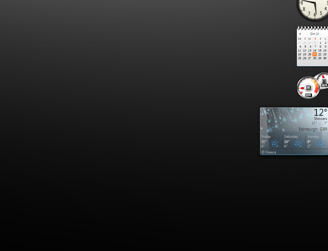

been getting flashing screens and occasions where the screen goes black
then it started creating blue lines on everything
the screen goes bright and it appears the PC is using onboard GFX (see pic)
the card (are they actually cards on laptops?) is an Nvidia Gforce 8400 GT
Im guessing the card is on its way out?
