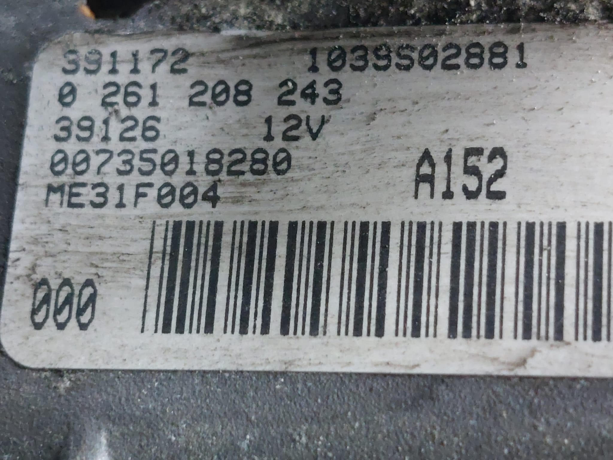

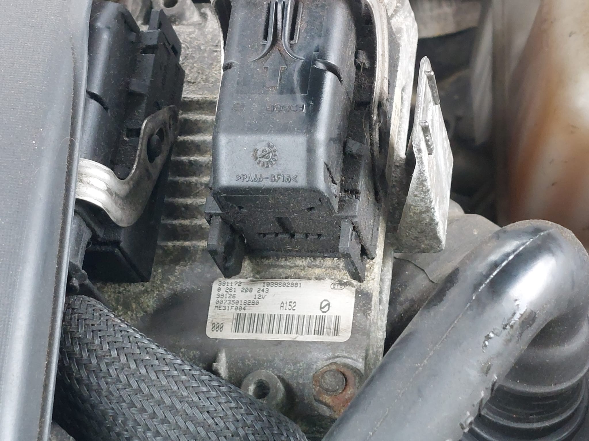

Hello people,
I'm Krys and I come from France.
We build a Lada Niva with Fiat Stilo Abarth engine and we did endurance race since 2020.
We have a programable ECU and it's not a good deal for this engine, we want to install original ECU from Fiat to have the best performance and the best fiability.
But the only one ECU that we have it come from Selespeed car and the number is HW: 0261206655 / SW: 1277356595
We installed ECU with new wiring, engine start but it's not possible to have more 2500 Rpm and it's not cool for racing.
We stopped everything because it's not possible to use original ECU withtout selespeed gearbox.
So I try to find ECU number and Bosch number software from Fiat Stilo Abarth with manual Gearbox, maybe someone here can tell me this information.
With this ECU, I think we can run with the engine without problem.
Thanks for your help.
