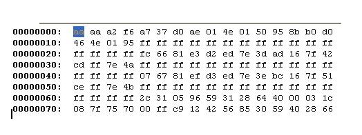

Here’s a typical receiver dump
It must be read in 16 bit to work.
Address 72h, 73h = 0. 7. 5. 7. unlock code
address 04h is the first entered remote code = 0. 7. 5. 7.
address 08h is the second remote code = 4. 7. 4. 2.
etc.
The key codes start at 04h, and each extra code starts 4 bytes later. This example has 4 keys installed.
To find the unlock code, run program rem.exe, then enter 4 bytes and press calculate.
The bytes following the key code + 20h and +40h are the rolling codes which alter with each door operation.
Byte 70h = next key position code in this case 8 words used
Byte 71h = no of door openings left before automatic locking
Byte 72h, 73h , = lock / unlock code of the key that locked the unit.
Its AA AA if it self locked
Byte 74h = 00 if unit locked
FF if unit unlocked
That’s about all I know about the unit
I have written rem.exe to decode the bytes if anyone wants it.
Tony.

Hello,
I have a similar alarm from Alfa 145 and I just read the eeprom 93c46B.
The file is very similar and I'd like to have the REM.EXE to calculate the PIN code, if possible.
On 72h and 73h I have AA AA, which is weird because it should be the lock/unlock code of the key that locked the unit. In your example it shows 75 70 which is the PIN backwards?
Thanks in advance for any help with this.
