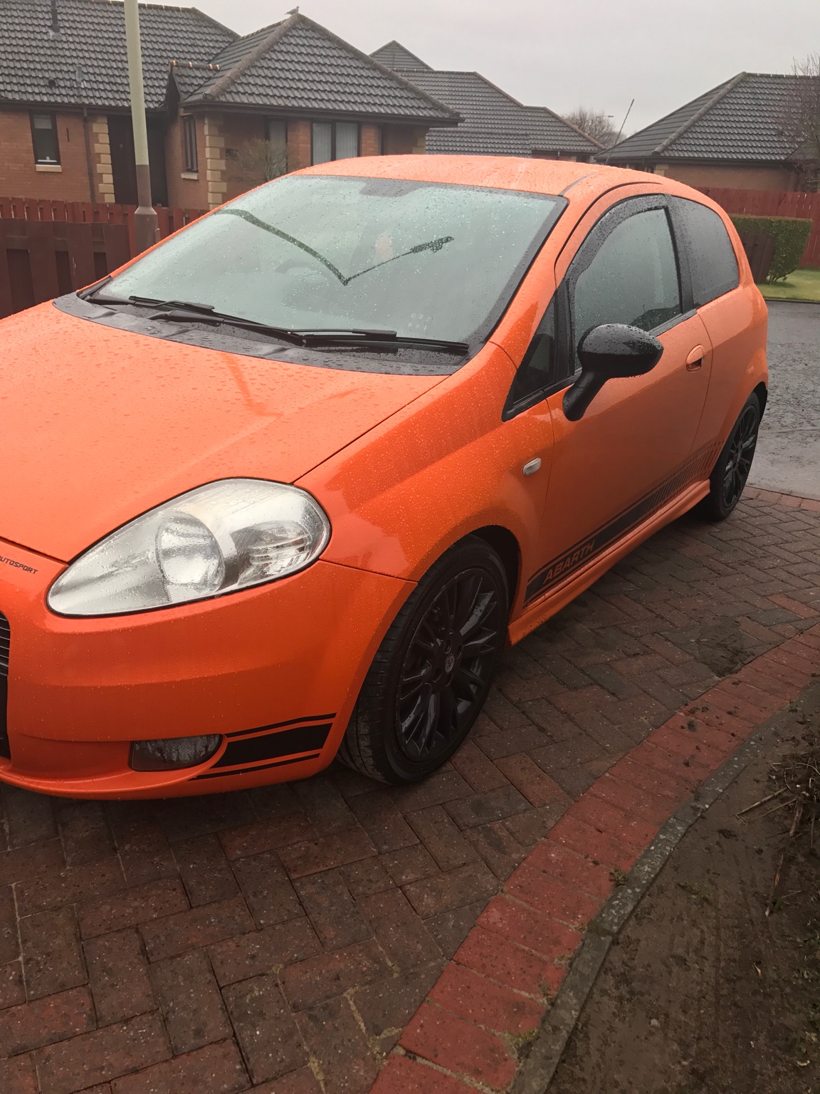

Hi all. New to the forums here as I have just bought a 55 plate Abarth grande punto registered in early 06. It has a few issues that I'm going to need sorted out and just looking for some advice and maybe an idea of what it's going to cost. First off is it doesn't always like finding 5th gear first time, especially if my foots down. Then we have a whine from the turbo. I've been told this is nothing to worry about, but I've also been told it means it's on its way out so any help is much appreciated here. Today it also struggled to start a few times with the dash telling me there was a radiator coolant temperature problem and it wouldn't start. Also once I started it today and I had no power steering. A simple off and on again sorted this out though. Any help with these issues is much appreciated. Thanks in advance.

Hi. It is a 55 plate but was registered in 2006. It just had a new battery before I bought it. Been advised to just take it back and get my money back but I'd rather keep it amd fix it up. Make it sound and look nice. Its a great car and very fast.

Apologies if it isn't the abarth model. It does have the scorpion badge on it in places and has abarth stickers along the bottom on both sides which both look factory as opposed to after market.

It's not an Abarth as such, as they didn't come out until 2008. They were only black, white or red, and yours looks pretty orange to me. (y)
It's probably a 120 T-jet with added badges?
