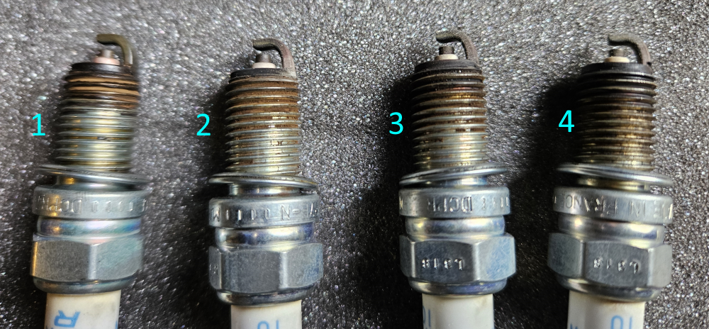

Spark plugs out (only 1300mi on them), and I could really see the difference in cyclinder 1's plug (miss fire code) and the rest...so they all get replaced, jumbled the coils around on install. Fired her up. no error codes 😄 Took her to a 40mile blast across country all seems well and happy.

Well its been a few weeks of fighting with the Panda, I took The H2 sensor (Bank 1) out checked the the sensor head and the electrical connector, all seemed well. Checked the cylinder 1 spark plug and was looking a bit knacked, so I replaced it (the rest were fine).
