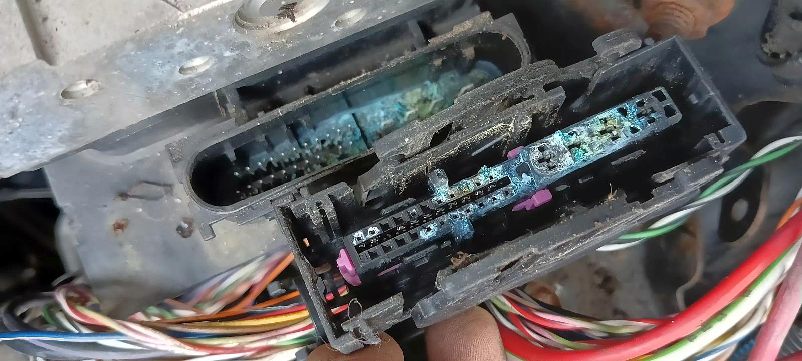

Quick update. I removed the front windscreen wipers followed by the scuttle panel to reveal the bulkhead area. It wasn't too bad in there but I gave the area a good clean to prevent future issues. The drainage tubes are clear so rainwater is able to escape but I may consider modifying these later to route water away from key parts like the alternator. I quickly ran out of daylight so I switched my focus to watching the CAN BUS Diagnosis video above before performing diagnostics. I checked for resistance on the CAN lines by probing pins 6 (+) and 14 (-) on the OBD2 port with a multimeter. The reading is 61.8 ohms, which I understand is a good result. This suggests that the main CAN lines on the BUS are fine (though there still could be a wiring issue local to a module). The ABS module is not reporting any errors in MES and I'm able to actuate the ABS Pump motor and drain/load valves. On the weekend, I'll take a closer look at the wiring around the ECM and ABS modules, in the bulkhead and between the ABS pump and sensors.
Nothing yet, unfortunately. I've got a feeling that the ground circuit for the ABS module is open. However, trawling through looms of wire looking for a fault is like looking for a needle in haystack, made all the more enjoyable by the recent cold snap.
