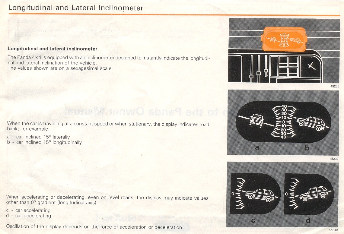

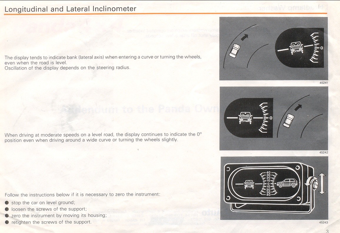

Whilst trawling through my bit'n'peices i came accross an addendum to the Panda Owner Manual, relating to the newly introduced inclinometer.
For those of you lucky enough to have one fitted, I attach a copy.
Incidentally, Fiat reckon that this device is quite reliable and accurate. My friend bought a 20k+ Japanese 'off-roader:rolleyes: ' with one fitted. The hand book stated that it was indicative and not to be relied on. Useful eh ?(y)
