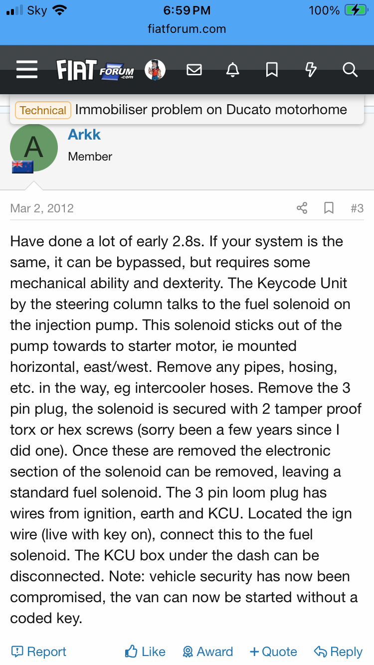

That’s from the forum from a few years ago if it’s any help. Looks like you’re not alone!

thanks for that just for clarification mine is a 2.8 d does the same apply. to many issues with the immobiliser need to see if i can bypass it.thanks again. Mark
Yes for 1.9td you can read 2.8D. For some reason I got that wrong. Too many distractions here with grandchildren visiting. Mayhem for this old fogey.
