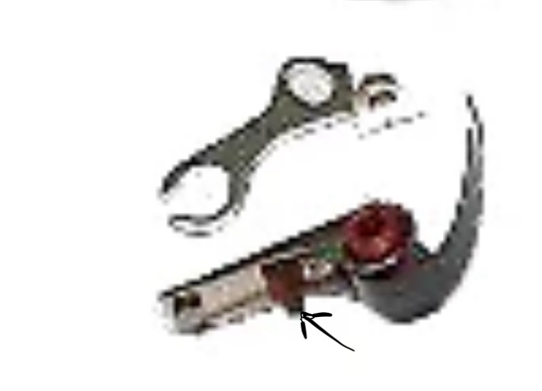

Hi. Thank you for your advice. It was the points which were closed due to wear on the point where the cam opens the switch/point.
I used the old ignition from the previous engine to work out what was going on. Attached is a picture and video I had sent to Totó from Ricambi who was
on WheelerDealers.
I used the old ignition from the previous engine to work out what was going on. Attached is a picture and video I had sent to Totó from Ricambi who was View attachment 461922on WheelerDealers.
