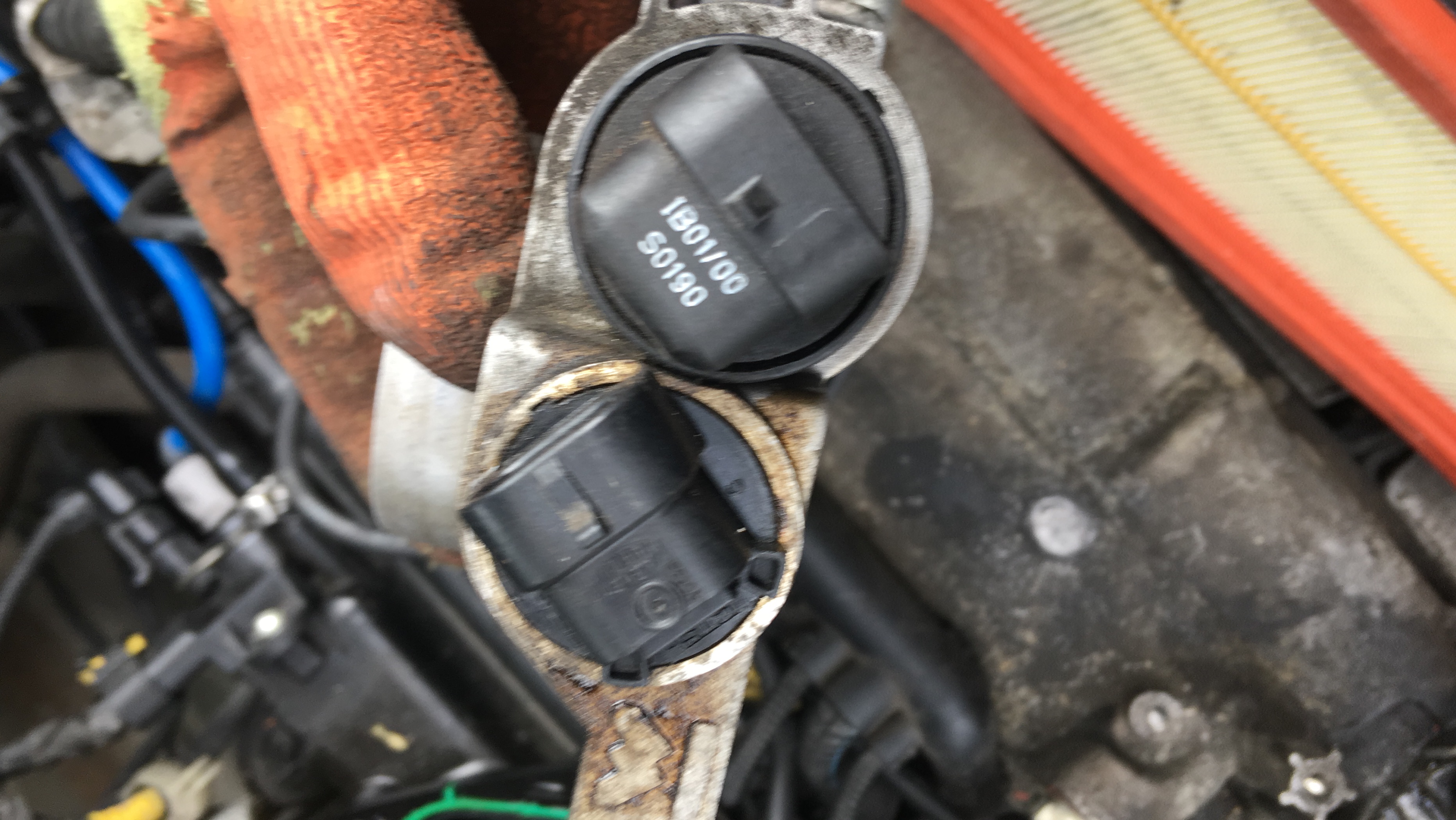

Hi everyone
Can anyone tell me what the two sensors are on the side of the throttle body on fiat panda 1.1 2010 please?
Just discovered a broken orange wire on the sensor on the left of the picture!
Thank you

Hi there
Thanks for info
These have caused me a headache for 4 weeks along with a broken cable on the TPS.
Decided to change throttle body with sensors in place as I can’t seem to separate these sensors from the body ???

Hi there
Thanks for info
The
there's pushed in. But nothing to pull on.
if you put a Hose clamp around them you can lever them out with a screwdriver.
Mark everything carefully First. But from memory they only fit one way but could be wrong.
be careful diagnosing TPS errors
a miss match between the throttle pedal and throttle position sensor can throw the same code
we seen a couple of throttle pedals fixed by compressed air along with a couple changed recently. And I have seen the connector corroded and gone green
