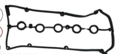

Do you mean about this rubber gasket , I've replaced it last year could it be installed wrong ?
Yes, this is the " Tappet cover gasket " I were talking about,
It is easy to twist or pinch the rubber during installation, mine started leaking badley after 10 months. So I ordered a new one and also saw were I made a mistake during the installation while changing.

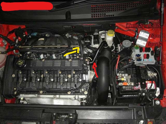

Update !
Last night I took my car from that mechanic, he told me that he couldn't find any other suspect leaking area except from the hose attached here from intake mainfold, he told me that he had put new clamp on it cleaned the surface, and according to him , after throttle body there was oil inside for sure coming fro vent mist, I'm glad there was no leak from any of engine gaskets, this could be accumulated long time ago so maybe after cleaning some time it will not leak oil from that area.
Thanx again !

I park mostly in a flat surface in front of my office, also at home in my garage which is flat surface, today I removed inlet manifold its seems that oil came during these years from oi vapor hose that is connected from the engine and now it found some ways to go out of the manifold there were also other areas with oil in mainfold not just the hose mentioned in previous picutres, I cleaned it well with degreaser so I don't believe that for some time it will leak again, I was happy that none of gaskets were faulty :D
