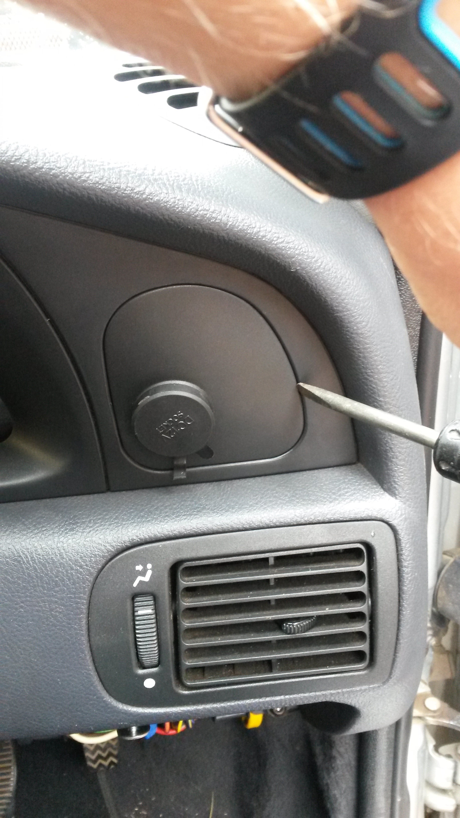

The first step is to remove the small side panel (in my case, to the right of the steering wheel). There is a small notch where my screw driver is that you can use.
