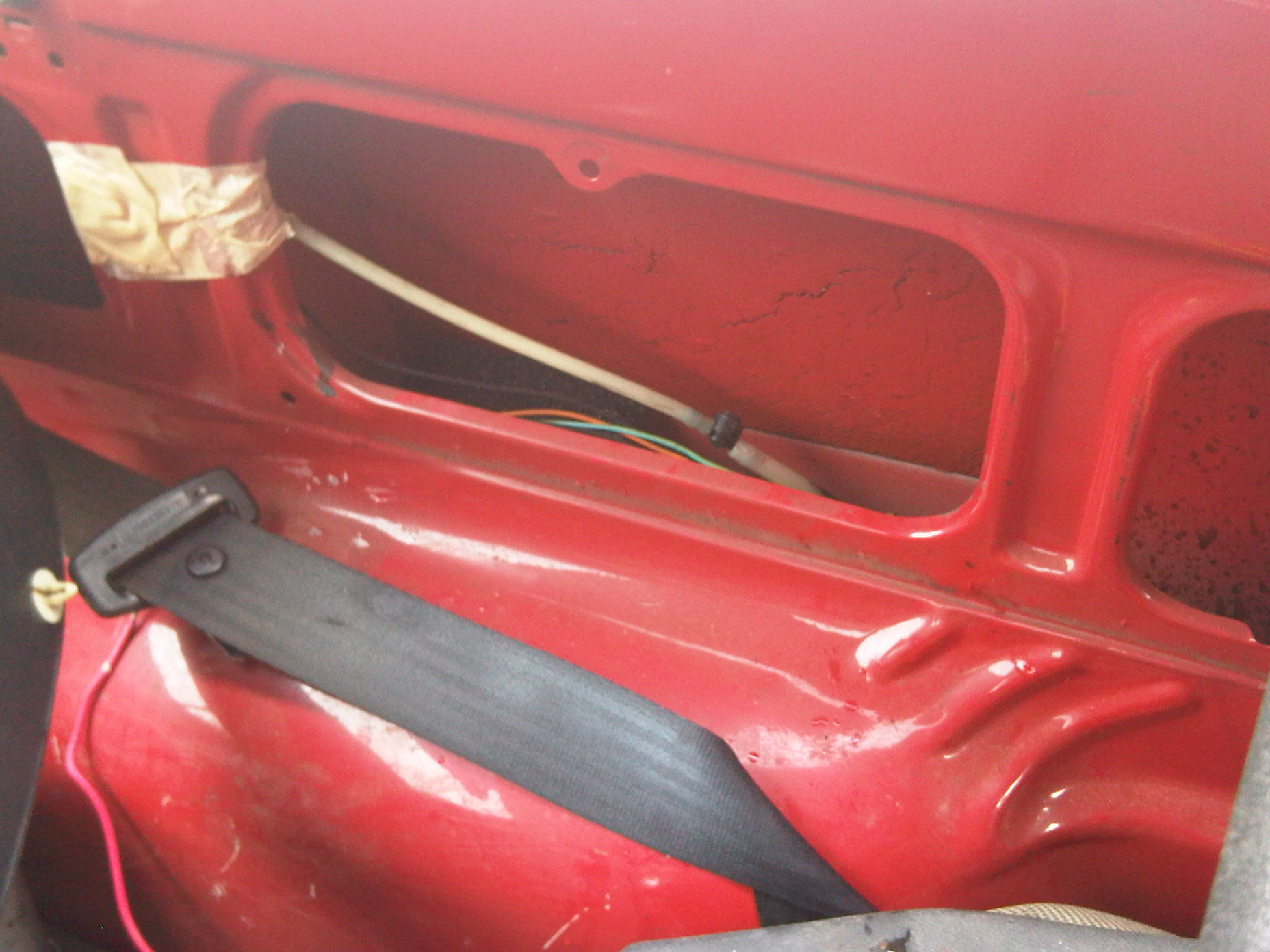

Locate the none return by removing the upholstered side pannel on the N/S (RHD models) in the rear of the car.

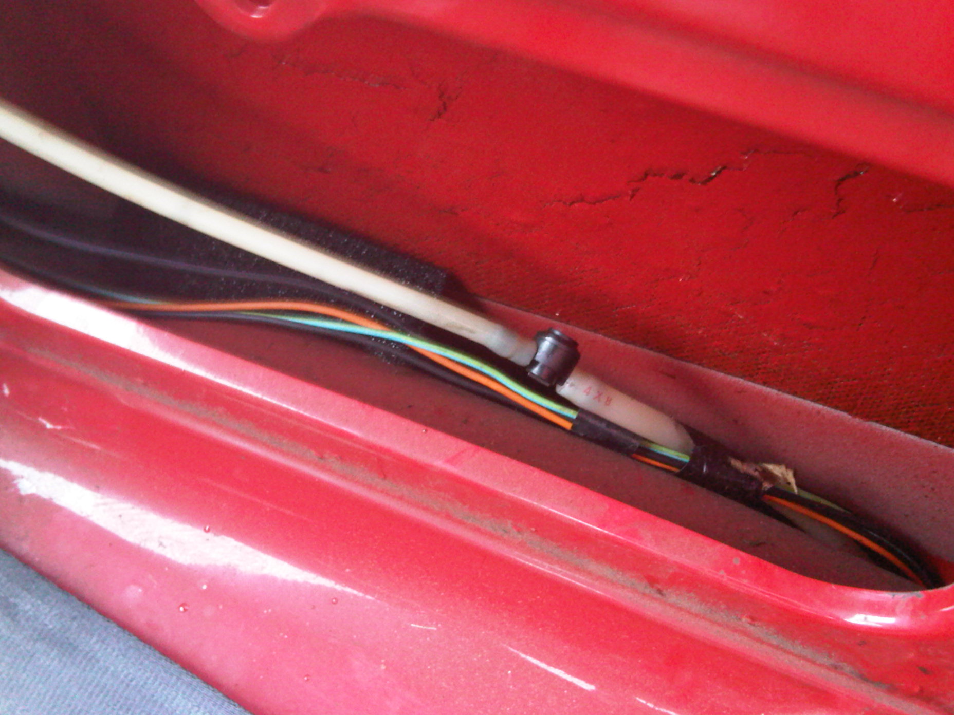

3) Once located remove the 'in' pipe to the blocked none return valve. This can be done using the pliers. Failing this, simply cut the none return valve out. It is important that the 'In' pipe is removed first!

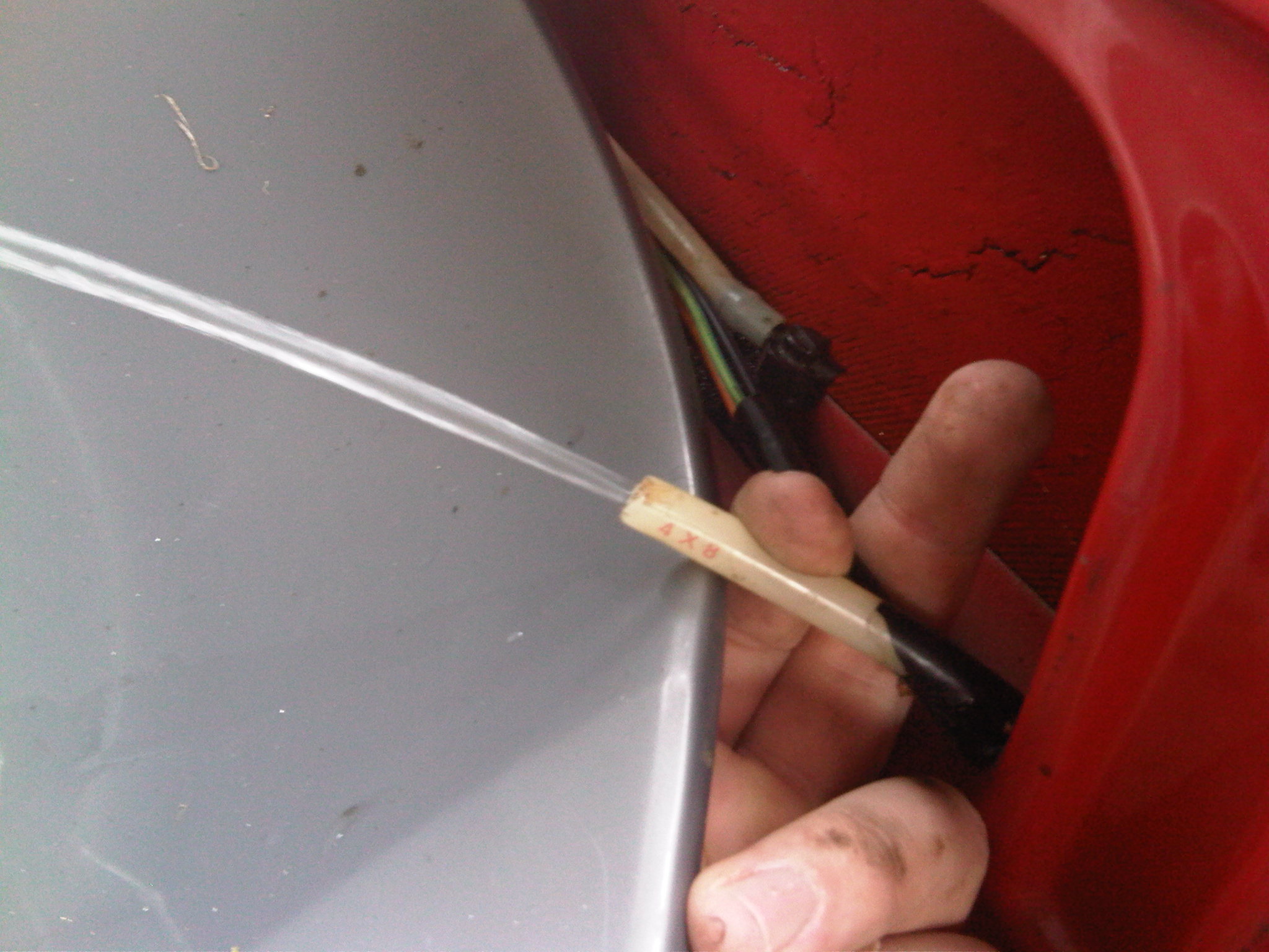

6) Now connect new none return valve to 'In' pipe. Ensure pipe is connected to the 'In' side of the valve, as shown by the water flow arrow.
7) Now remove the 'Out' pipe from the blocked none return valve. Ensure the pipe is over the bucket at this point as the content of the pipe to the rear jet will drain back out of the pipe very quickly, and will go all over the inside of the car if its not in the bucket!
8) Now connect the 'Out' pipe to the 'Out' side of the none return valve.
Again get a helper to activate the rear screen wash. Water should now flow out of the rear wash jet.
