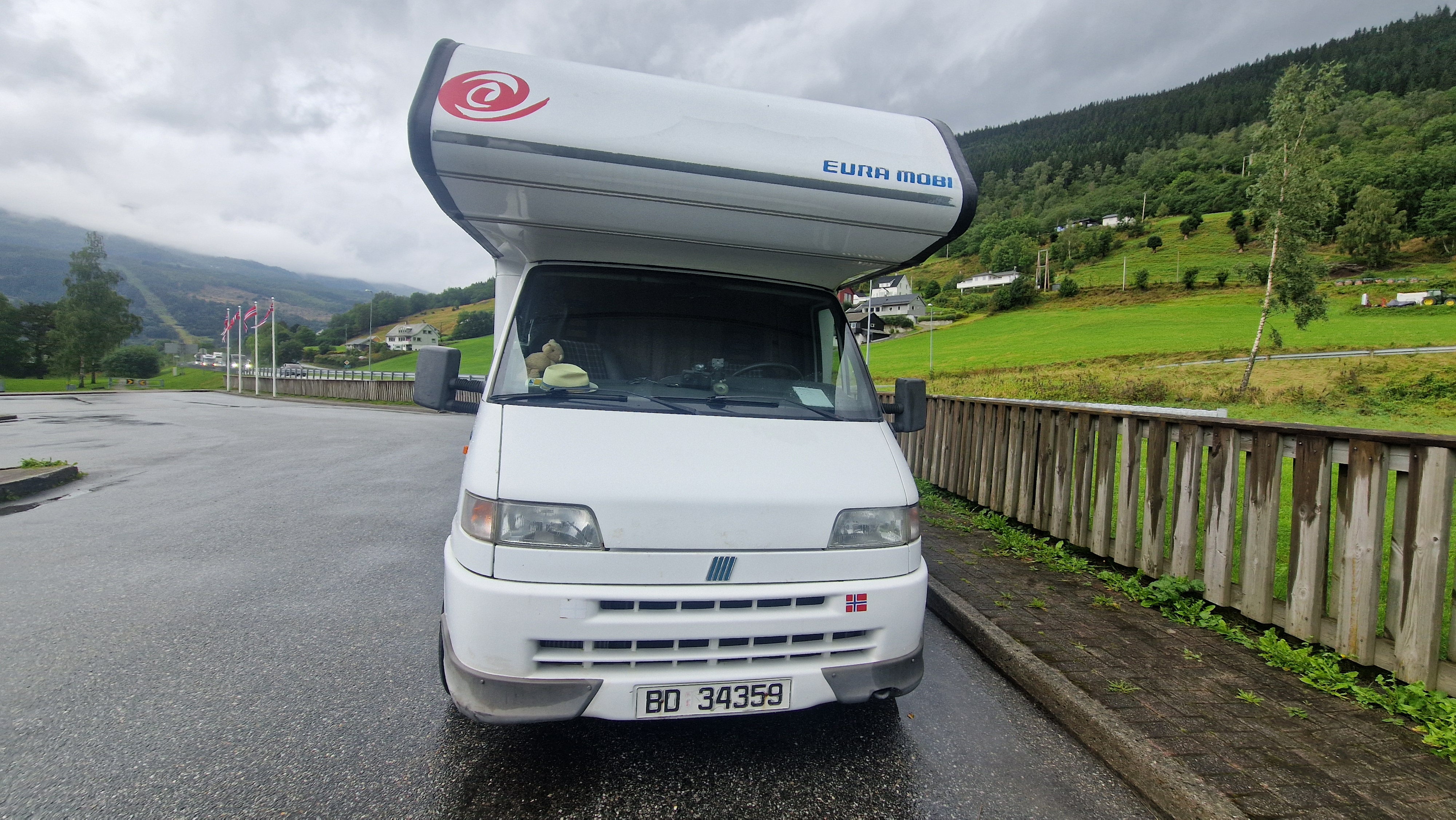

My dear camper van with an FIAT ducato 2,8 IDTD (motor code 8140.43) has just had a heart stroke and need a new heart.
In other words. Im looking for help to get my dear car on the road again for new adventures. For a swift fix I had the plan on buying a complete engine with the turbo and all the parts standing on the travers and then do a swap. But I cannot find the right engine (2,8 idtd 90kw/122hp) anywhere. However there are several 2,8jtd engines available, and even 2,8Hdi from peugeut boxer. So is it possible to mount the 2,8jtd in my car if I also get the ecu over. Some people say it just a breese, and other states that this is buying a **** load of troubles.
Im not interessted in guesses, but tips from someone that accually have done this operation.
BUT im most intersted in tracking down a good function engine that are the same as my current one that just died :-/
