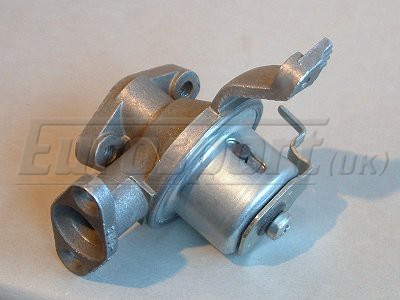

Hi, i have replaced my heater valve about 2 years ago but as i move the slider the valve opens and closes but it has started to leak coolant out.Will undoing the screw on the end of the valve help the coolant stop or do i need to fit another valve
Thanks Shaun

I think it is time for a new valve.
IIRC, the screw is only there to hold the lever in place. The valve is listed as a replacement part, if something goes wrong with it, there is no way to rebuild it.
Where is it leaking from?
Hi bludvl_x19
I think it is coming out of the end where the screw is, i will have another lookn today
Thanks Shaun
Shaun - bludvl is exactly right. The screw just holds the plate that holds the lever arm on.
My 1300's is leaking from the exact same spot. I have a new one - just waiting better weather to fit. Its a replacement only option I'm afraid. Should have lasted more than two years though. Your photo is from Eurosport UK - thats where I got mine from - good guys and should do you well..........
For now just close off the air-flow flap and turn the heater slide to cold to ensure minimal water flow until you replace it. If you start the engine (and hence raise the water pressure) just release the coolant cap to release the pressure or it will continue to drip.
