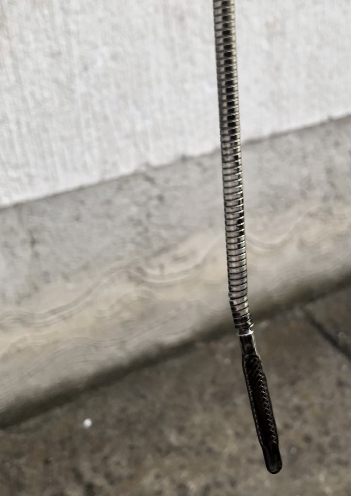

Hello, bought this car 2 months ago and in the beggining everything was fine (or I thought so). Soon enough I noticed dark spots on the parking spot. Its been leaking for a while, lets say a 1-2 drops a day for a month and a half already and I cant seem to notice the engine oil level go down yet. The car has 1.3mjet and has 170k on the clock. Didnt have much free time to bring it to a serious mechanic, although one did a quick inspecton on it and couldnt determine where does it come from since its spreaded out from everyday driving... Does anyone else have the same leaking spots? I will provide videos and picture in addition. Thanks in advance!
