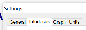

Hello,
For the connection problem, you have to scan for the interfaces and choose the one that was found. It happened to my on the previous version (5.0?) very often.
With the 5.1 as far as I remember I haven't had the problem anymore.
Left bottom corner:
Then Interfaces tab:
And at the bottom:
You can also test the previously selected interfaces with the test button on the right hand side of each interface line.

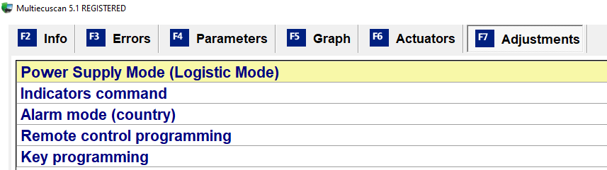

As for the programming itself, on the information you posted above on your car, in my 5.1 version I found that:
Then
And in the adjustment tab:
Contrary to the Ducato model, it says that the procedure will do for both key and fob. At the end the instructions tells us to also test the central locking:
Be sure to read and apply the procedure :) Good luck :)
