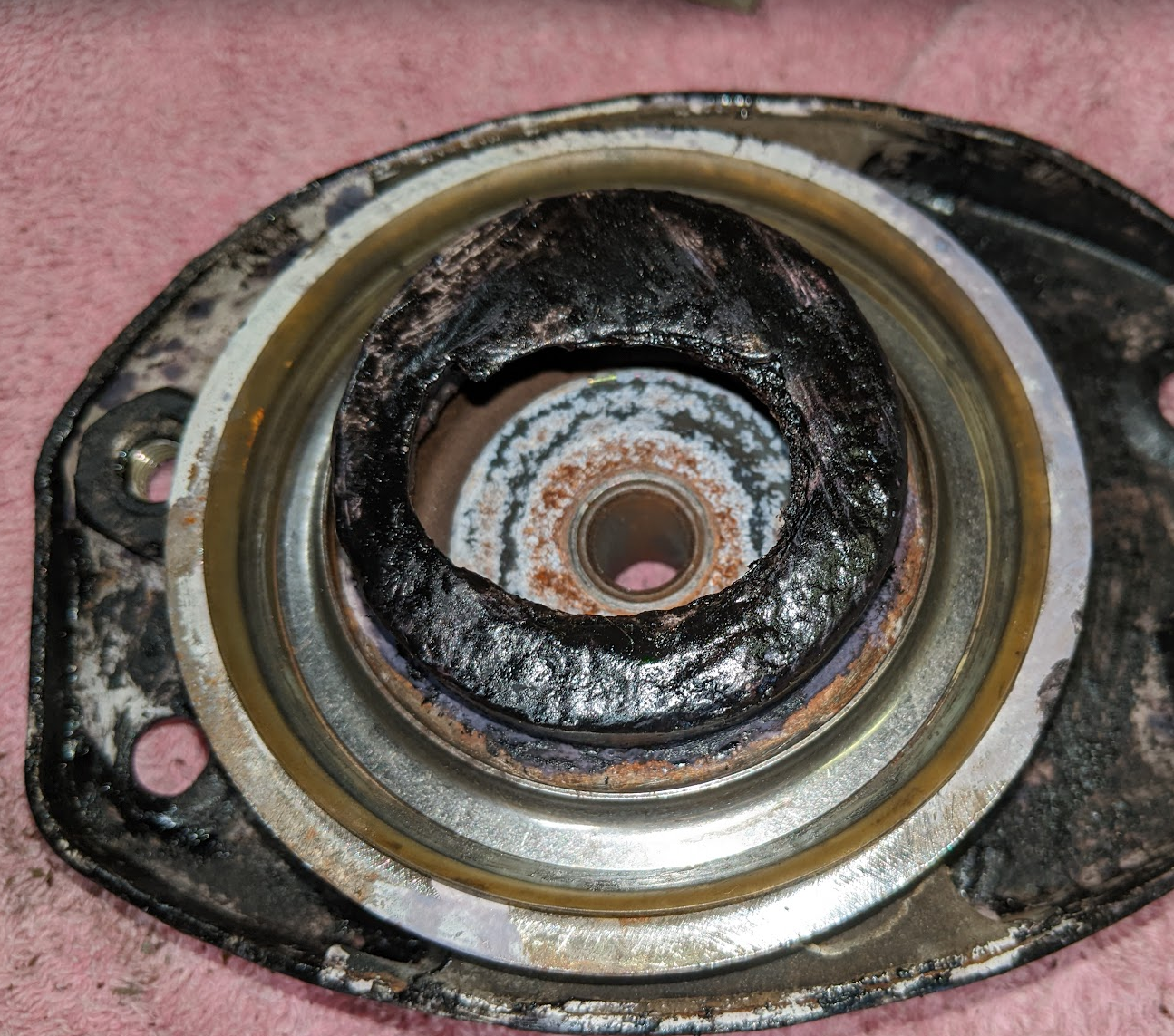

One of the bits that I was wary of was losing the bearings as I dismantled the shock. I nearly lost them but was OK. I did take pictures of the order of assembly for refererence.
All the pieces (except for the 42 ball bearings)
First the large seal:
Then the inner metal ring:
Now some greasy bearings:
followed by the second metal piece and then seal:
Then the spring mount goes on top:
While the mount does clip over the lip there's no guarantee it'll stay on so I was careful to always hold it as a unit.
