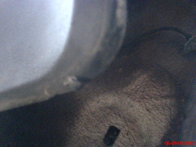

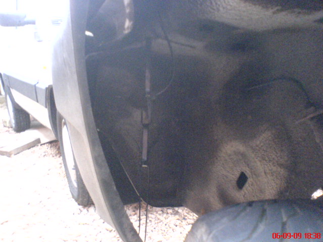

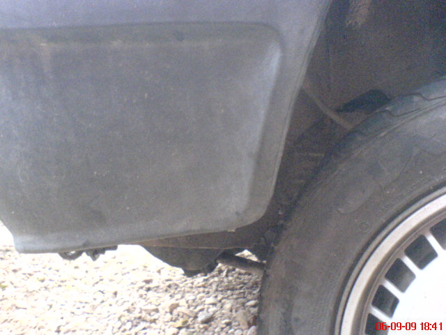

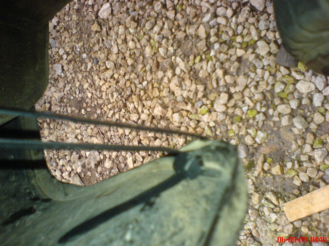

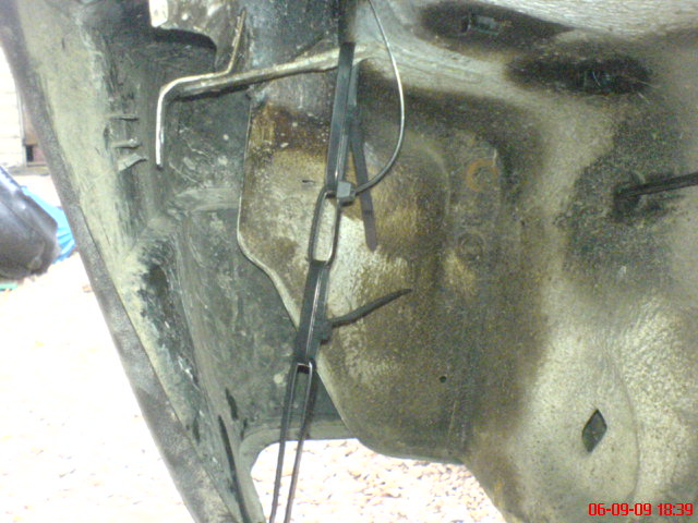

quick fix for the front bumper = 4xtie wraps round mounting bracket. Requires 1/4" hole in lower edge of bumper - pulls bumper up and in. Would be suitable for MOT fix as it feels quite secure (tie wraps will be hid behind plastic wheel arch protector). At least - I hope - this will hold until I get time to try out the new superglue stuff I've bought (that I was assured would work...)
photos 2 and 3 show that it's just about invisible...
