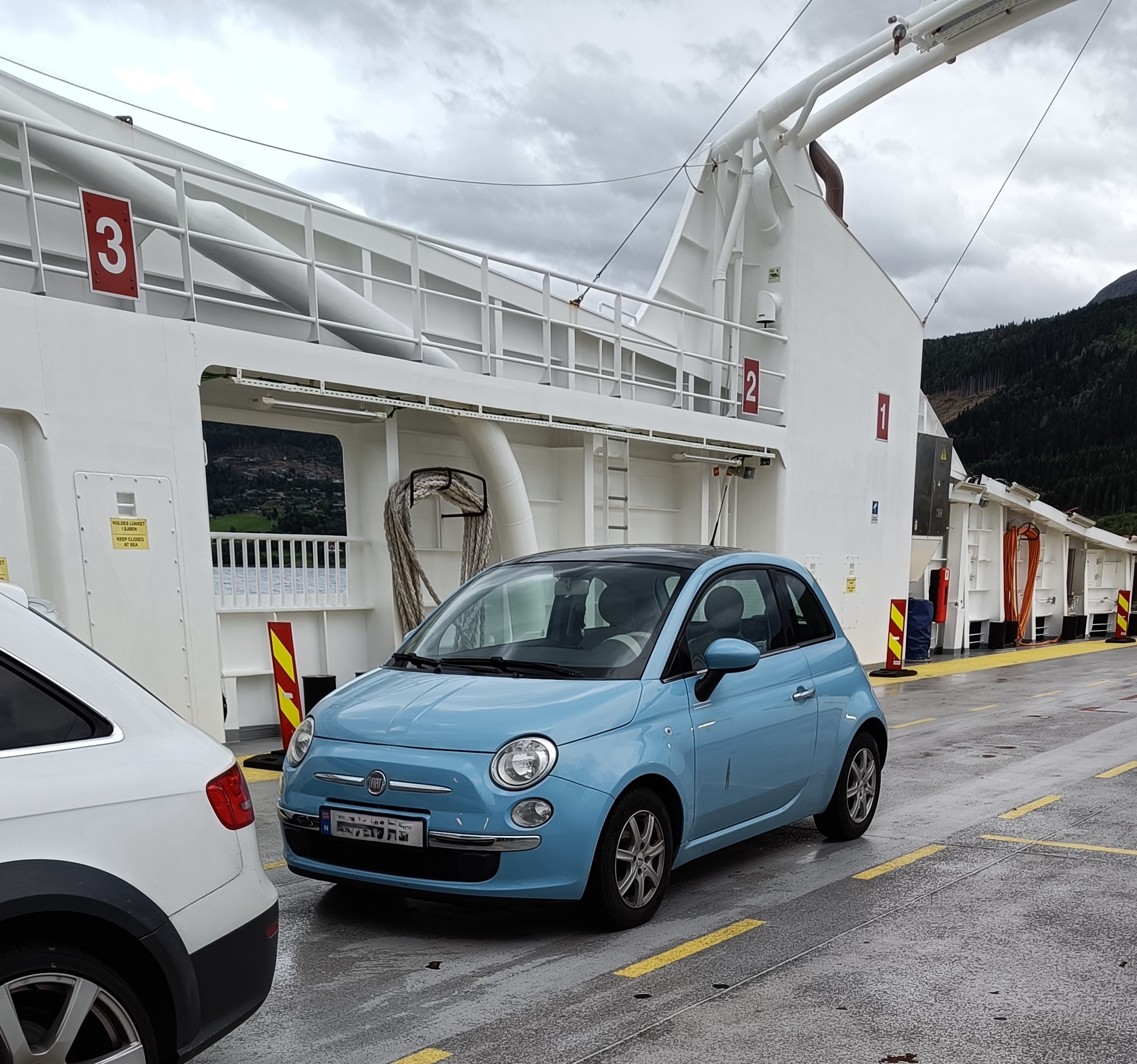

Hello! I got my long sought after gorgeous blue Fiat 500 a couple of months ago. It's a 2011 Twinair, low mileage, pretty good condition. I haven't really taken any glory pictures yet, but here's one from the ferry trip on the way to its new home. Nevermind the bird-bomb on the side of the door, it was included in the purchase, and washed off as soon as I got home. Picked it up in the south-east of Norway, and drove it to med middle of the country (almost 500 km away).
