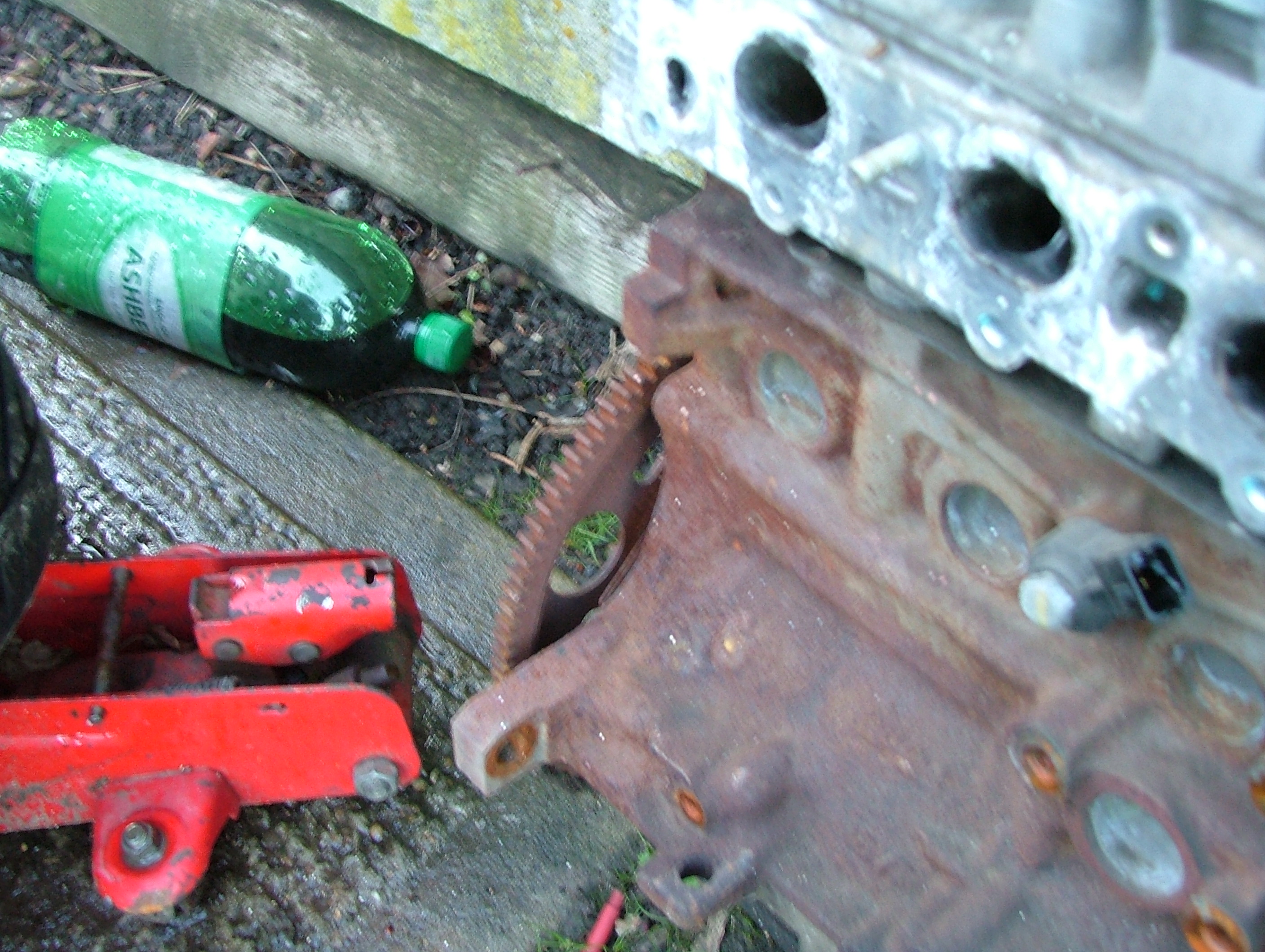

Hi daughter has a 1.2 16v auto '02 plate and it was having trouble starting so got a reconditioned starter and asked me to fit it.
Well discovered that around 6 teeth on the flywheel are broken.
So is it worth fixing 11 months mot left full service and 60000 miles,and all in all good condition

i dont think anyone replying to this thread has even seen a punto auto fly wheel, ring gear for these is just spot welded on.
your best bet is to just get a used one from a breaker or friendly forum member ;)

don't forget a heavy torque converter bolts to that ( must be unbolted before removing gearbox)
