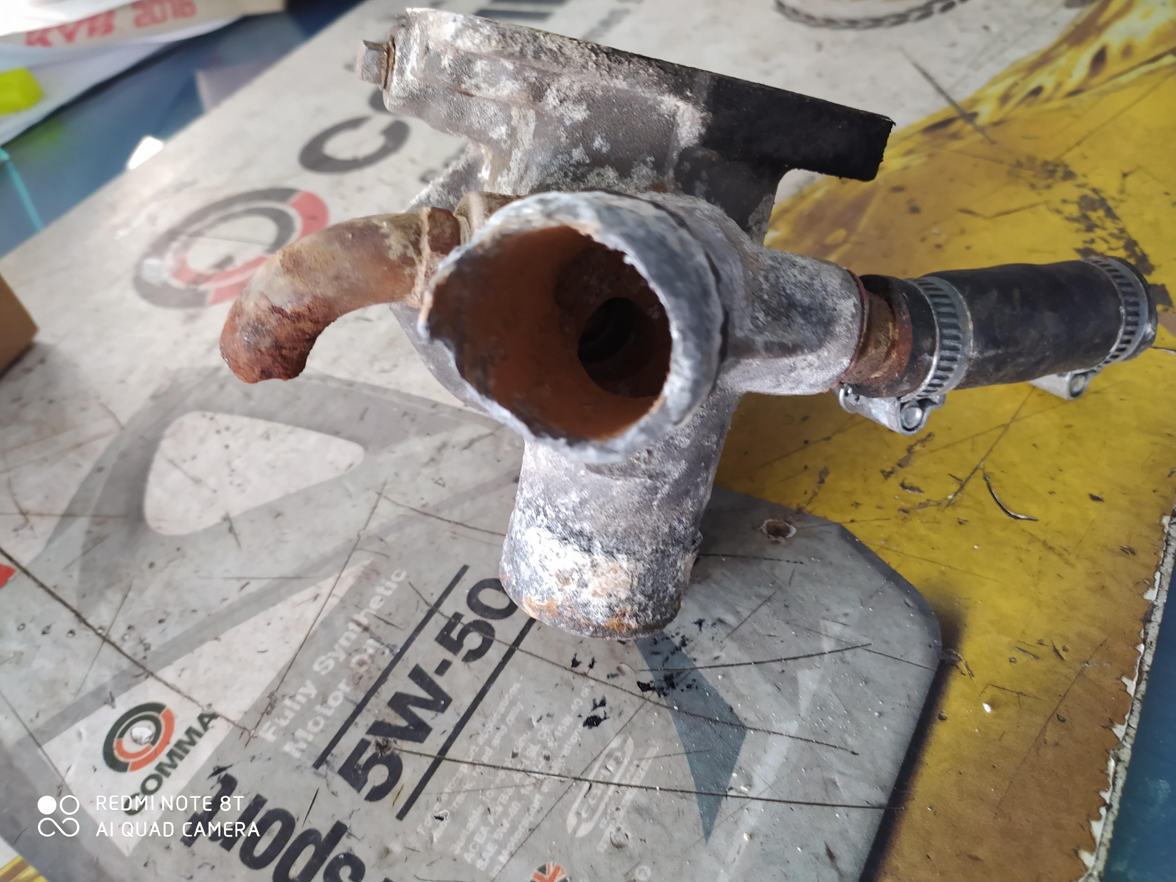

Post a photo of your thermostat housing.
Keep looking online a used one will turn up eventually.
Thanks for the encouragement, after nearly a year of looking for the part & the van being off the road I'm feeling a little discouraged. Pics of the old part attached.
What a beauty!
That looks correct for the part number you previously quoted.
Consider finding a tube that will be a close fit sliding into the corroded away stub . Clean inside of stub really well and bond the tube into the housing using strong heat resistant epoxy. Then cut the tube to the stub length you want.
Peugeot and citroen vans of the same era used the same engines , I'm sure you know that if not search for housing from Peugeot or citroen.
