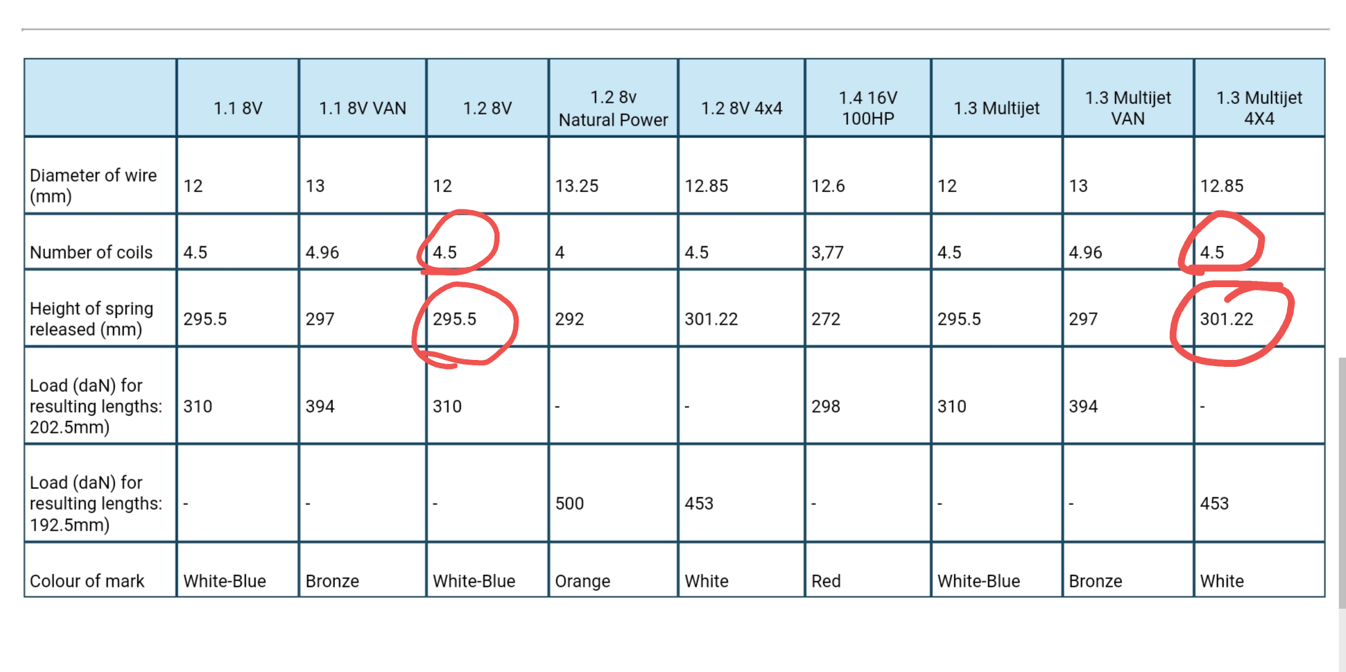

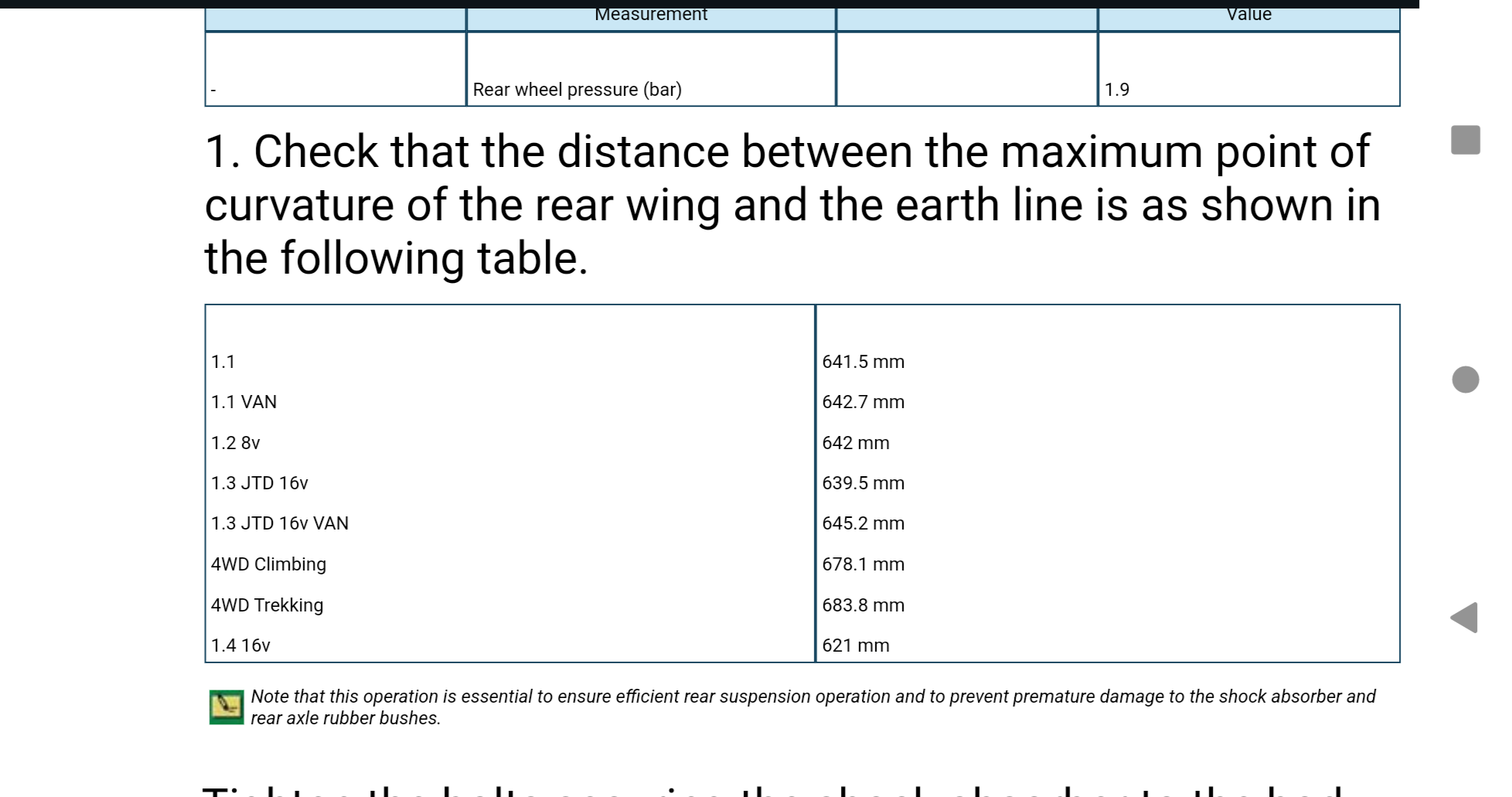

No idea if the mounting points are the same
Heres the ride heights for the rear
Rear springs being stiffer should raise the height a far bit though
Probably worth it for off road, the 0.8mm extra thickness in the coils will not compress so easily going over rough surfaces
