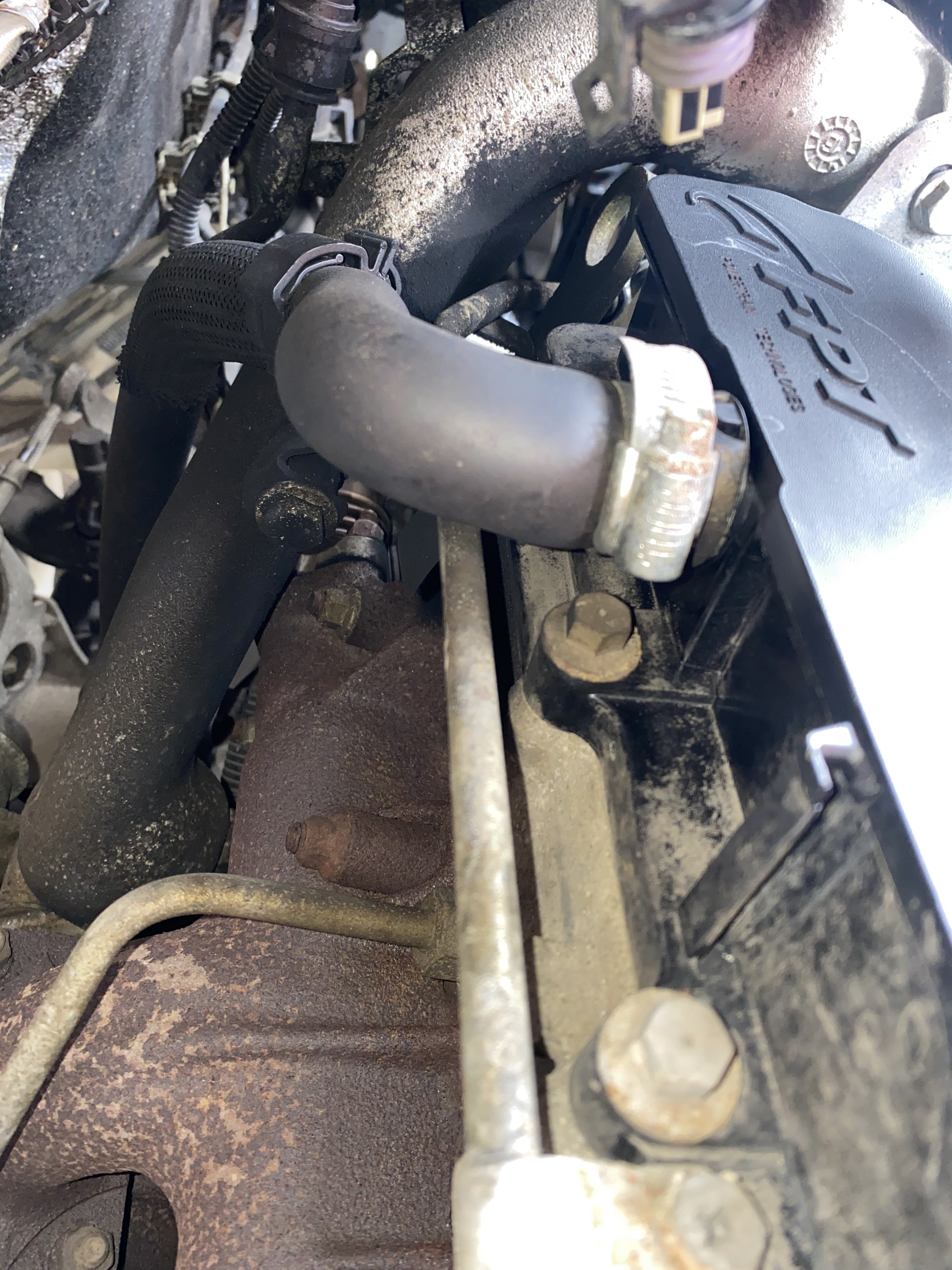

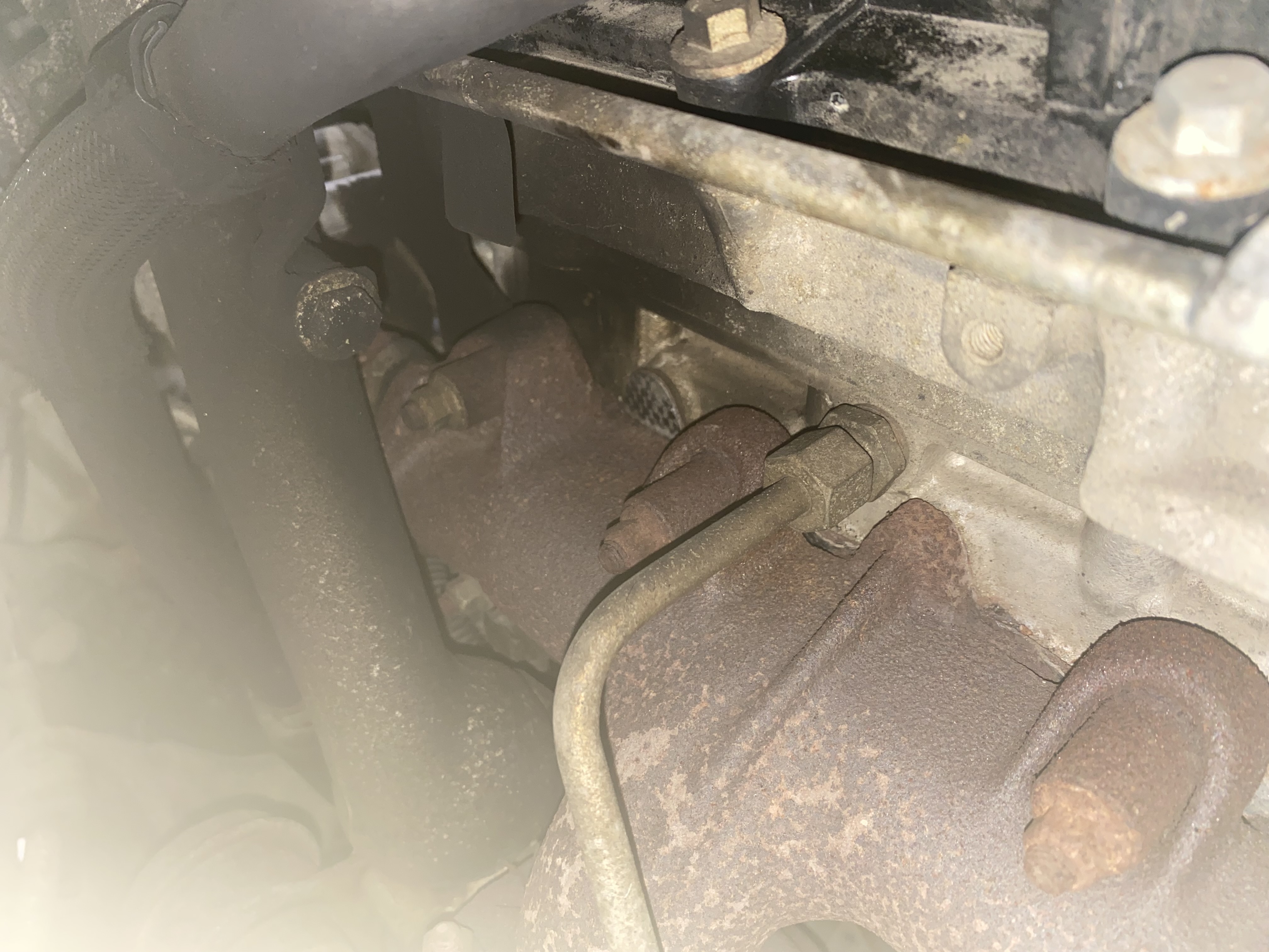

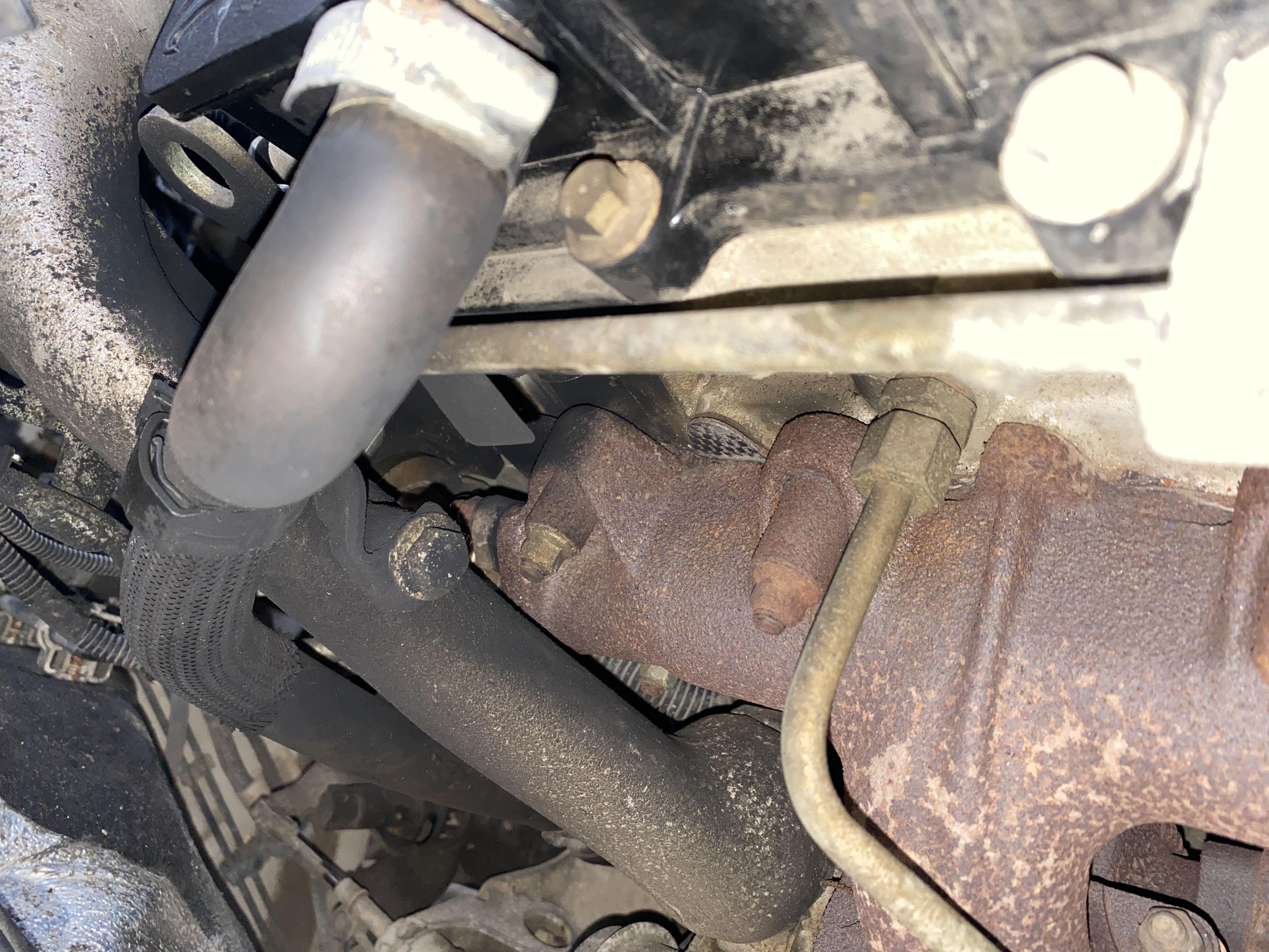

Thank you for the answer. I would like to ask you if it appears in the dashboard when it does this DPF cleaning ? Because at mine only showed the “check engine”. Today I spoke all day with different people and they said that it must have been a coincidence that the check light dissapeard after I filled it up with oil. Today I left down the oil and I had that 1 l extra which I put in last night. Today at sunlight I noticed that when I accelerate it leaves smoke. I took some pictures and I’ll attache them. I am looking forward to your answer. Thank you

I agree with @Greasytrucker it does look sooty at end of exhaust manifold area.
Are you sure it was white smoke you saw which can be an indication of the Regen side we talked about.
Engine oil tends to be more"blue smoke" and too much diesel is more "black smoke"
Having had another look at the photos of sooty area is that near the EGR valve/cooler etc, as soot may be from there?
Sometimes if it makes noise you can locate with a damp rag over parts to see if muffles the noise as a way of locating it.

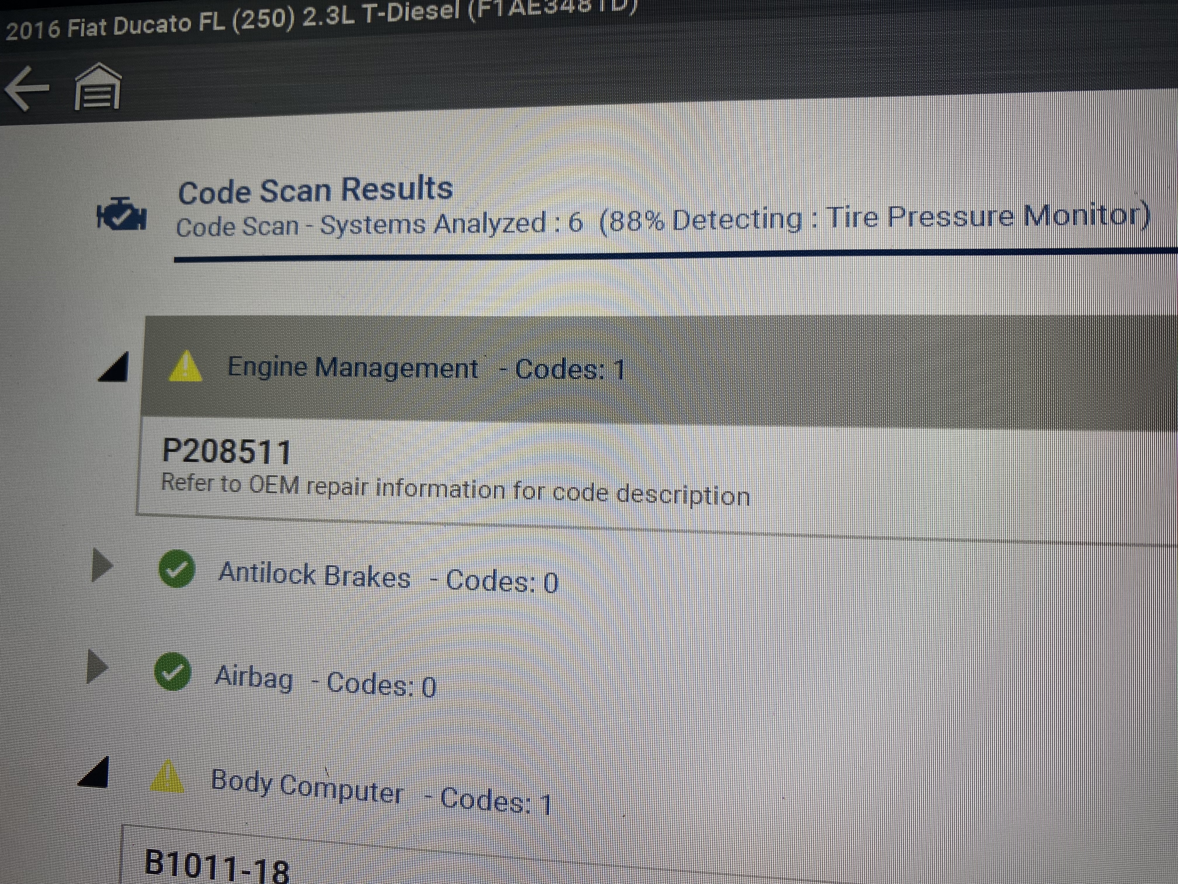

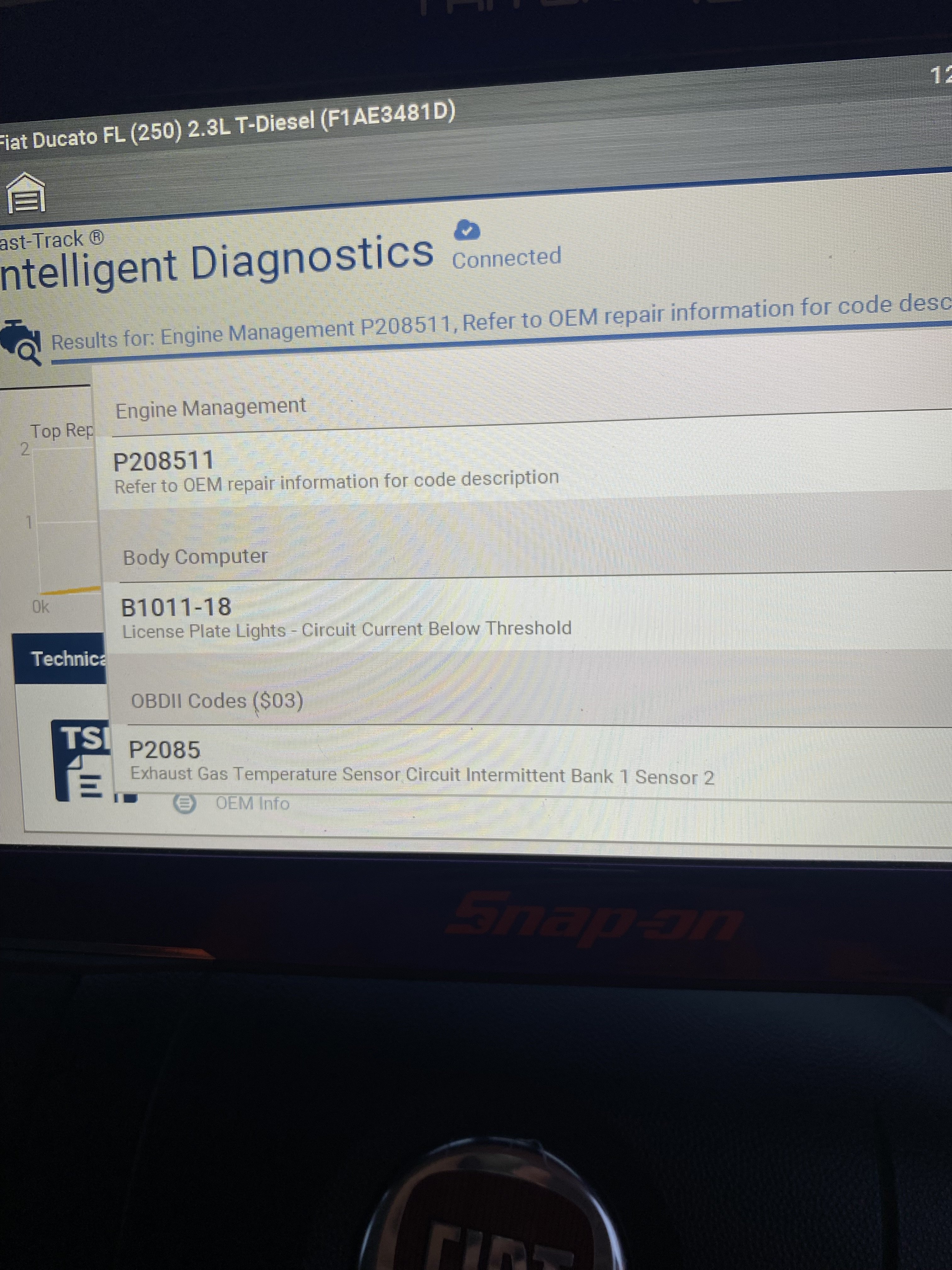

Today we put the tester and gove that errors now I ordered the gasket and I change it when arriwe . The smoke was white I leave the oil down and I have the same amount what I put when I change the oil so that means is not eating a gr of oil hopefully is just regenerating and the smoke under the bonnet is beacause the gasket
Looking at the video I am not sure it is the exhaust gasket, but blowing from further to the left beyond the exhaust manifold.
Possible the EGR cooler area?
What do you think, my eyes are 71 years old;)
I bought this van from 3 weeks the egr is brand new the seller tell me and I can see it as well is brand new . I alredy ordered the manifold gasket and this week will be changed and hopefully the problem is gone because all this time the van has full power and the check engine is dissapear
To me the exhaust leak is from the exhaust manifold to the EGR rather than the Exhaust manifold to the cylinder head, from looking at your first set of photos and the right hand one.
