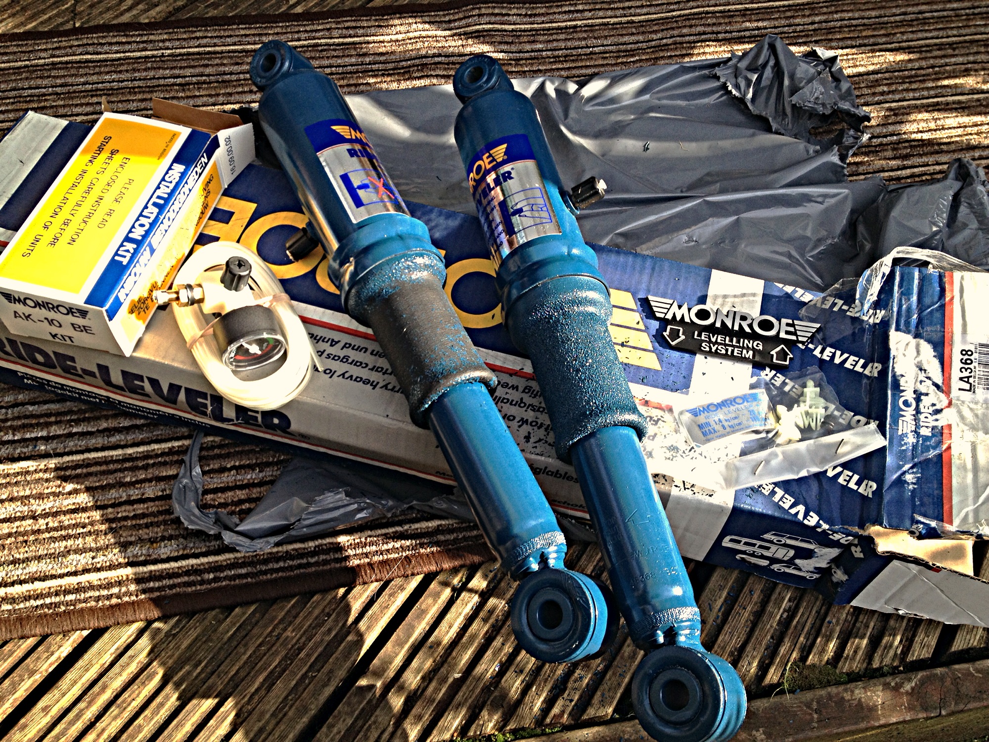

I would just like to share this with any fellow doblo'ers.
I have just purchased these and fitted them and i am absolutely amazed by the increased handling and better body roll.
After taking my old shocks off i quickly realized that these were absolutely screwed. you could put the shocks in but they wouldn't come back out by there selves" SCREWED.
These new ones have a minimal pressure of 20psi and can go up to 120psi. WOZERS!!
so the more you load, the more you increase the pressure to get it to sit up to original height again.
I often carry exceptional weight in the back of my doblo and after replacing the front suspension completely (at a cost of £350) (shocks - mounts - arms - bolts - springs) i noticed the back was sat down way too far. hence the replacement. keep the FIVE-0's eye off me thanks""""
I actually got these from eBay. they were supposed to be £233 but was on a discounted rate of £120...cha ching...bought.
