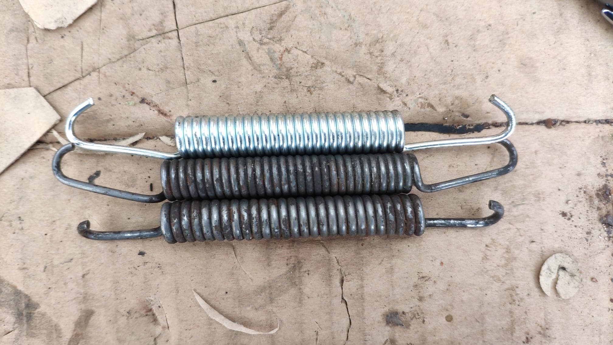

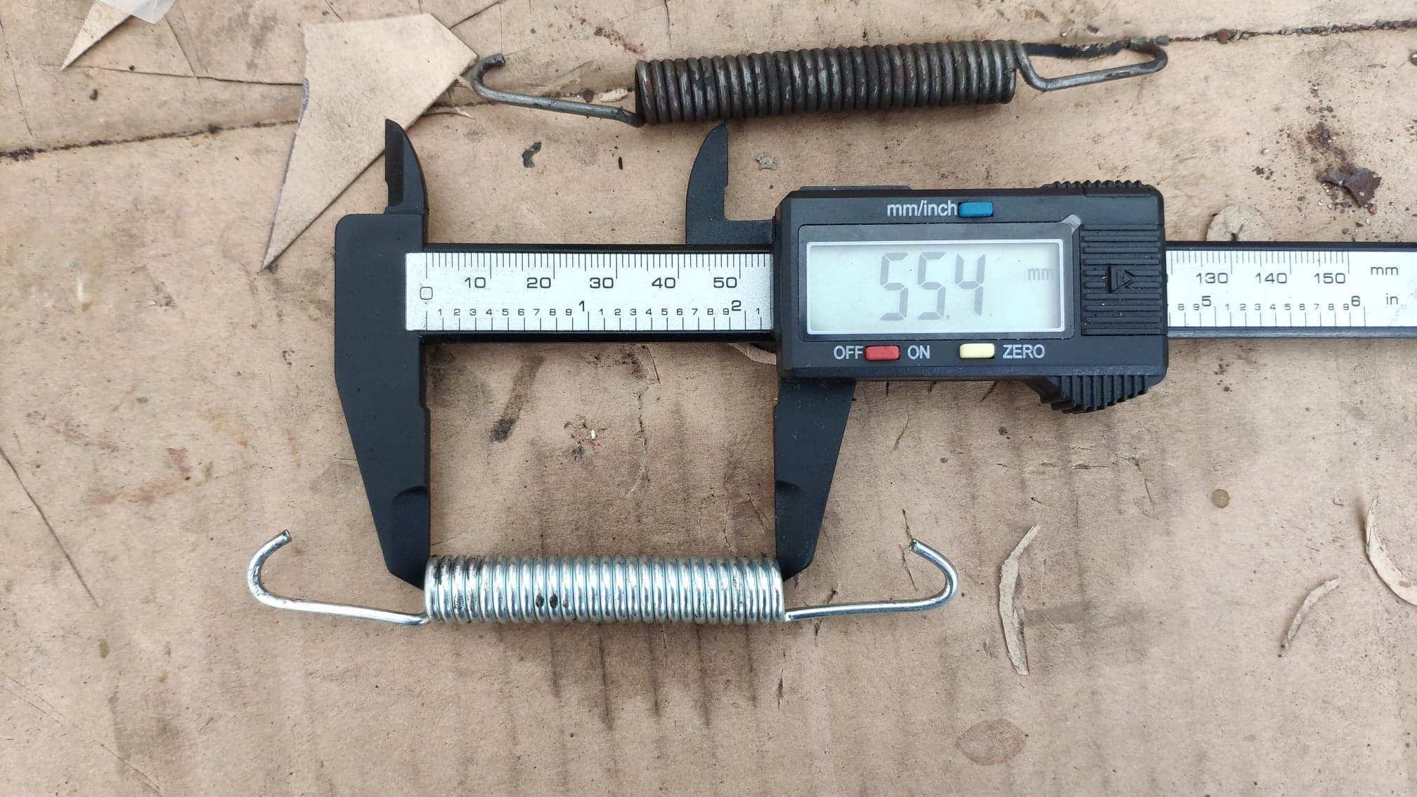

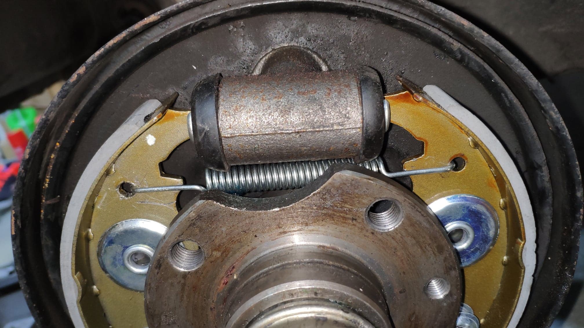

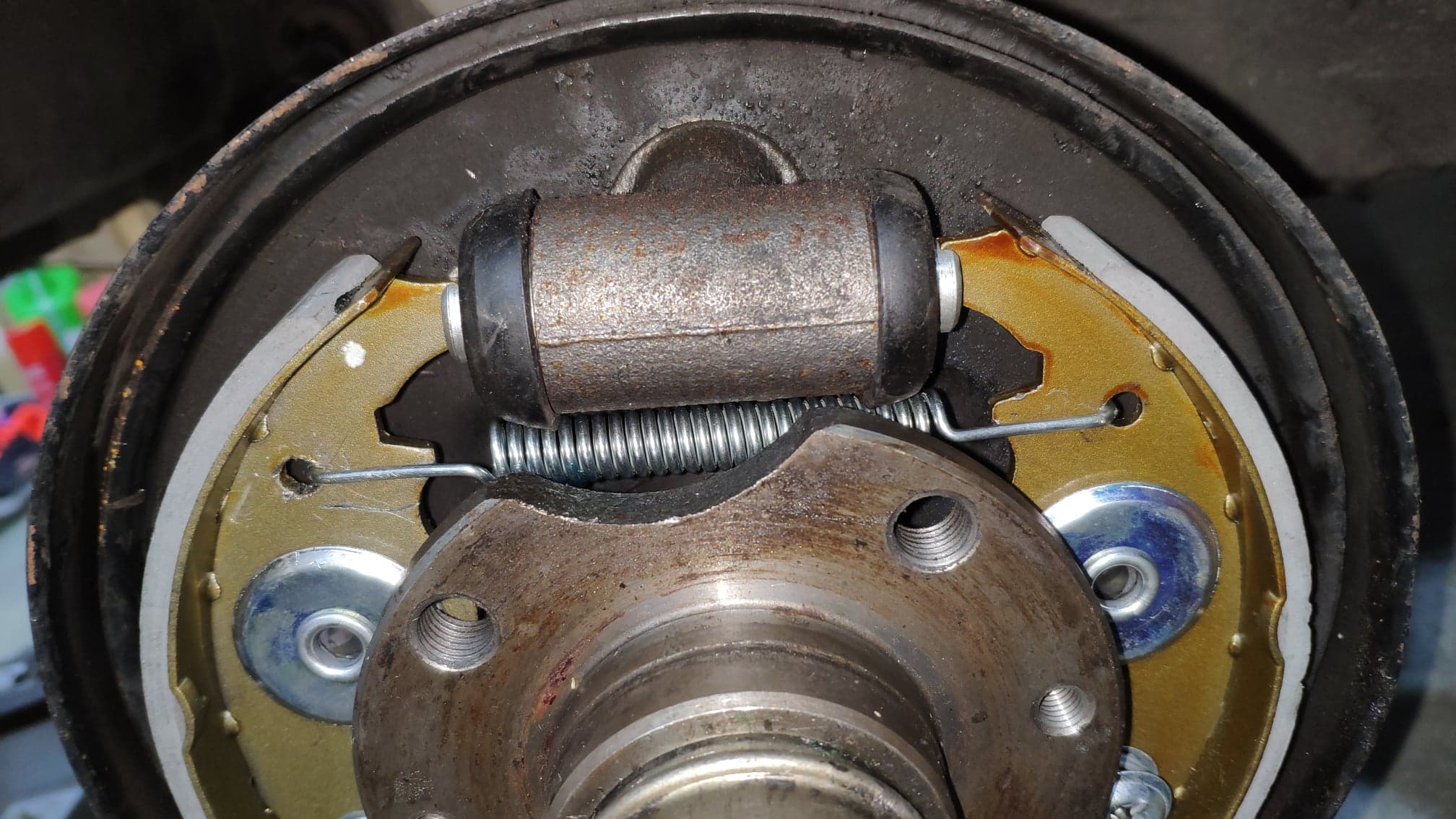

I think that sums me up perfectly haha. I found them again (thankfully I have the bad habit of keeping old parts), measured them (see attached pics) and yeah it looks like the old springs are actually a fair bit longer. I also measured the coils to be slightly smaller in diameter (about 11.3mm vs 11.7mm for the newer ones) which may have contributed too.
Anyway, I installed the old springs onto the car and I've finally got my 126 fully up and running again! It seems like there's still a bit of an issue with the springs vs the shoes (when I push out the shoes they keep retracting, so it seems like the springs are still too strong or the shoes springs are too weak), but definitely driveable now with decent brake pressure. I think I might try increase the length of the new springs I took out to see if I can get them to be a bit weaker for the shoes.
Another somewhat unrelated question too, I changed the oil today along with the brakes. When doing that, I stupidly didn't pay attention to how it was filling into the rocker cover and had a fair amount of the stuff overflow. I tried to clean most of it up where I could, but I think there was a decent amount which went behind the engine and down the airbox with the fan. I've left it alone for today, but would it be safe to start with some oil potentially covering parts of the engine and probably around one of the spark plugs too? I've heard of engine oil fires being a thing so thought I would check (especially since taking that cover off seems to be a massive pain)
Again, thanks guys for giving me this advice and reading through my original post! It's crazy how long it took to sort such a simple problem, but it feels so good to finally sort it out (or at least know what was wrong)

That's great news that you've got your brakes working reasonably well again.
When measuring the springs, it would probably be better to measure between the insides of the hooks at either end because in the case of your springs there's a significant difference between the lengths of the coiled sections. Doing it this way allows you to compare the length of the spring with the distance between the holes in the brake shoes where it fits before trying to stretch the new spring.
Point to note about springs. A spring can be regarded as a torsion bar, just in a coiled shape. 2 main factors determine the strength of a torsion bar, length of bar and diameter of bar. The longer the bar, the easier it can be twisted, the shorter the bar, the harder it will be to twist. The thinner the bar, the easier it can be twisted, the thicker the bar, the harder it will be to twist. In the case of a spring, the total length of the wire used (which is not the same as the length of the spring) and the diameter of the wire determine it's strength.
