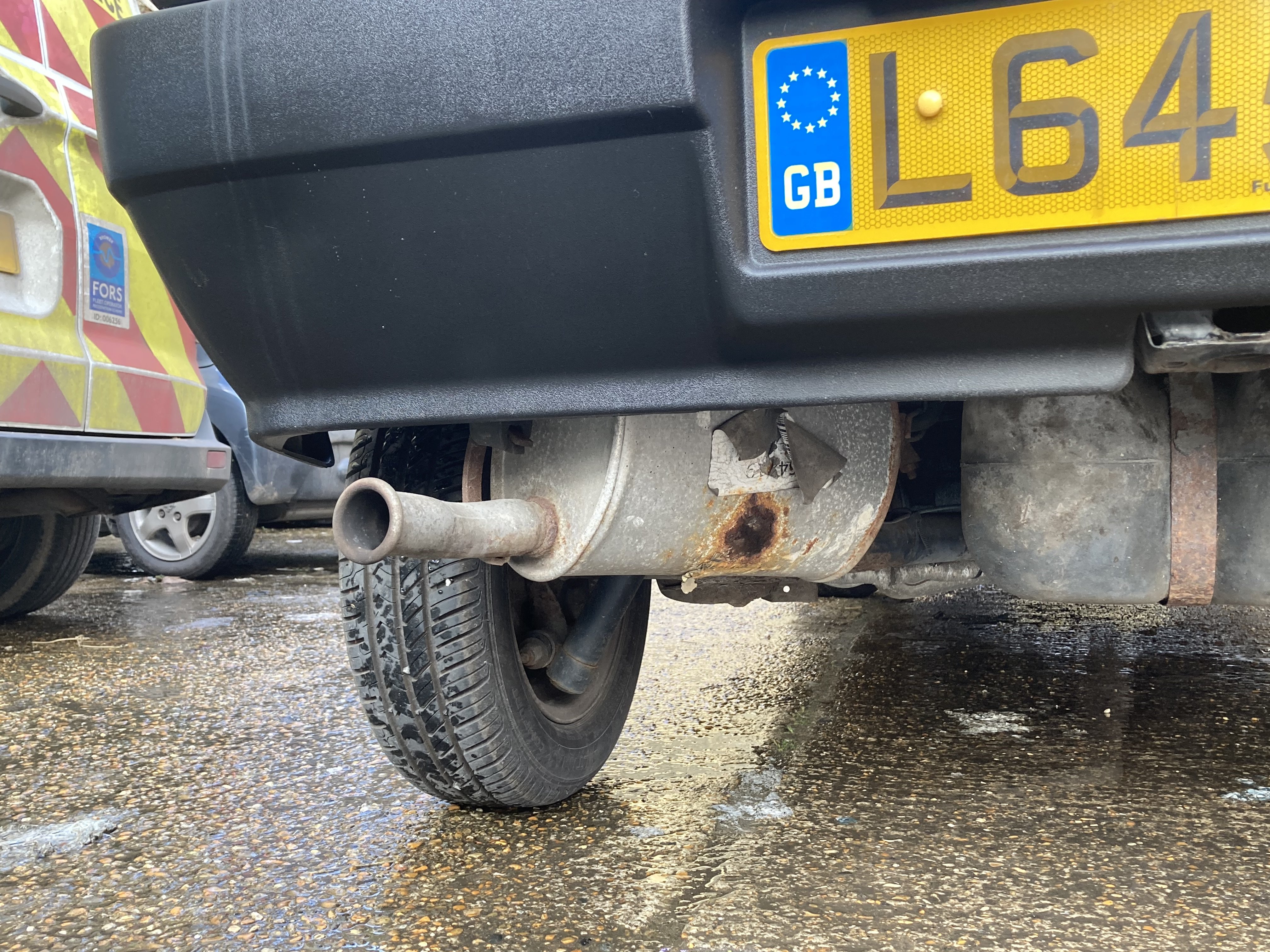

I had a stainless steel back box and pipe made up for Manda, in February, at Classic & Custom Exhausts in Hastings.
I’d struggled for ages to find any one who held a suitable replacement in stock (or someone who could order one in).
Very pleased with the result and the lifetime guarantee it came with. The exhaust now sits flush under the bumper, rather than hanging stupidly low. She sounds a wee bit ‘meatier’ due to the wider rear pipe (but not excessively) and seems happier on the A roads than before. I’m certain she is a bit quicker on pull away and acceleration but that could just be psychological.
