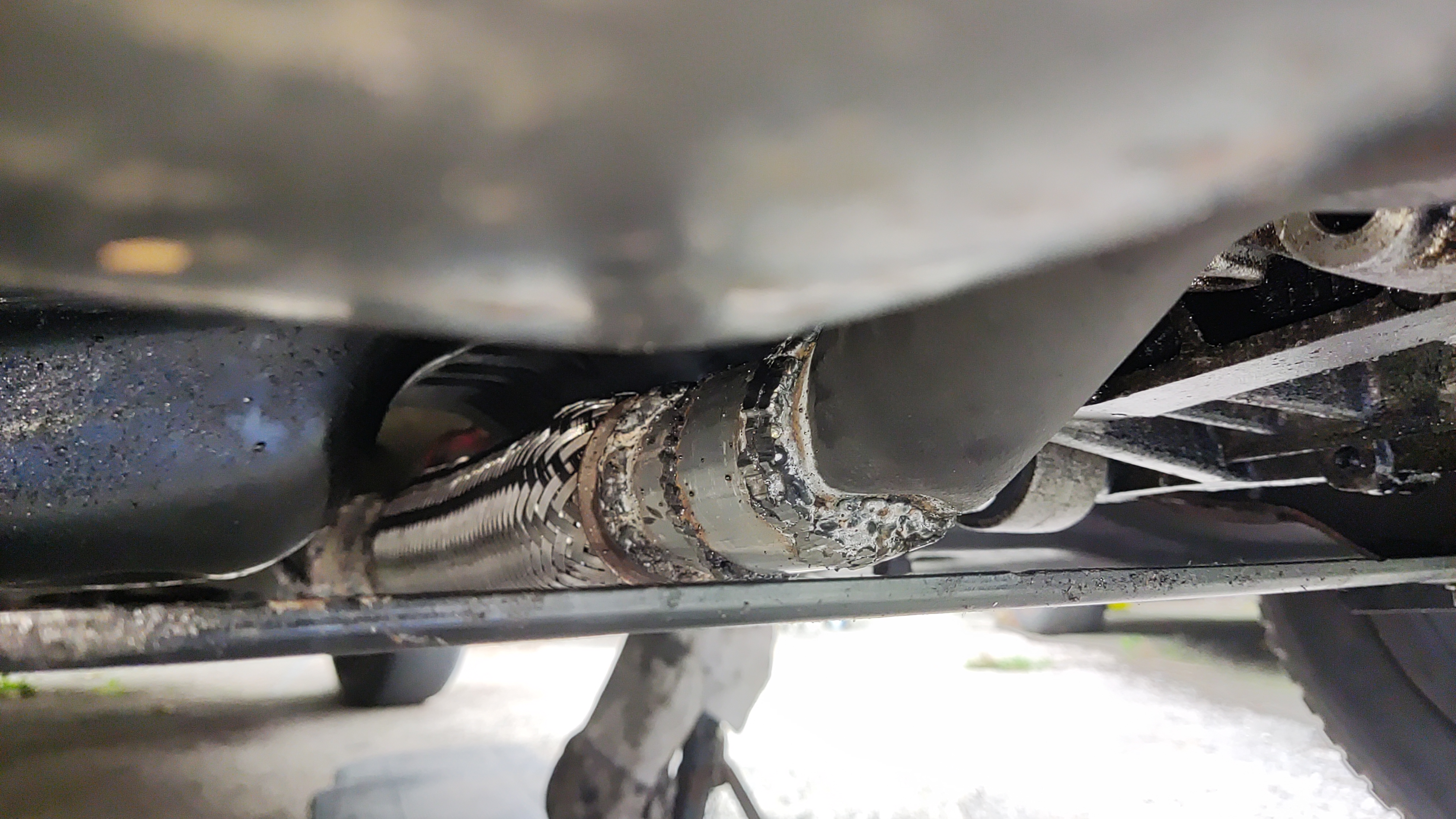

- cut 2cm of 52mm pipe and attach to your exhaust pipe, 1cm in, which you removed from the car and weld it around. It's great opportunity to learn and train your welding skills as you're working out of the car.
- Now you can fit flexi pipe to your welded extension - and weld it together.
- Now cut another 2cm of your 52mm spare pipe and weld it to other side of flexi pipe.

12. When all done, fitted and matched, THEN WELD while fitted, just bottom side, so this way you're sure that is correct angle etc. DISCONNECT BATTERY FOR WELDING ON THE CAR!
13. Slide out whole exhaust again so while hanging you get more space and better access to the top of it, weld weld weld...
Job done.
As you can see my welding is really very bad, but I don't care, I'm learning it, it was my second time welding in my whole life, most important thing is: it does work and it's 100% seal.
