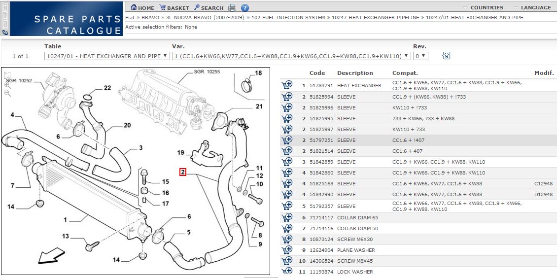

Does any one have a eper for a mk2 fiat bravo 1.6 d multyjet dynamic 2008 ?
I'm desperately looking for an intercooler pipe but can't find one anywhere.
The only eper I can find is for a mk1 bravo.
Much help thanks
Sp does anyone know what part number I should be looking for??
Unless it's item 3 or 5 you need, there are several different part numbers for the pipes depending on VIN, engine number or spares number.
If you want to PM me your VIN, and which pipe you need, I'll check it on a later version of ePER for you.

It looks like number 5 I want ?

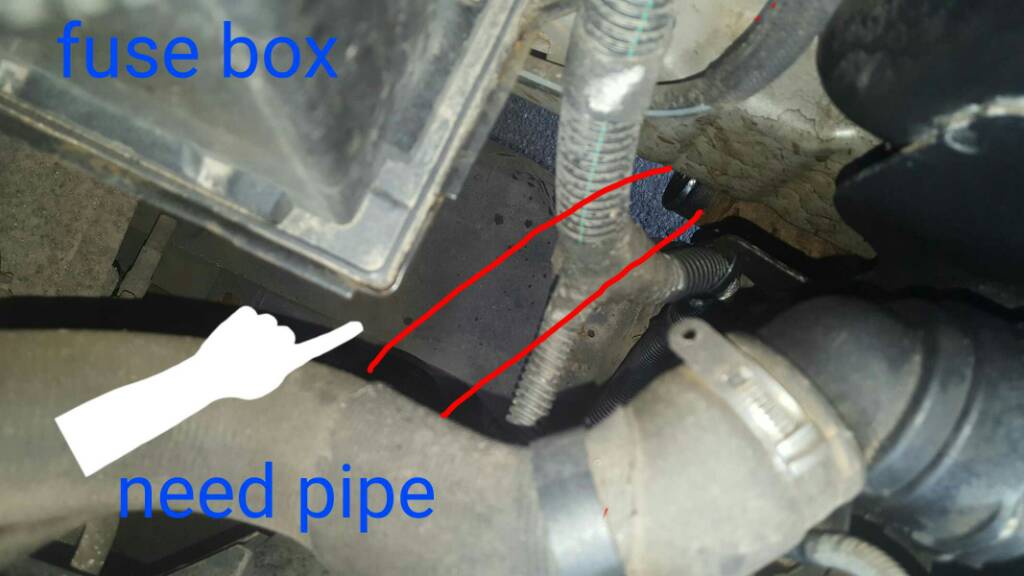

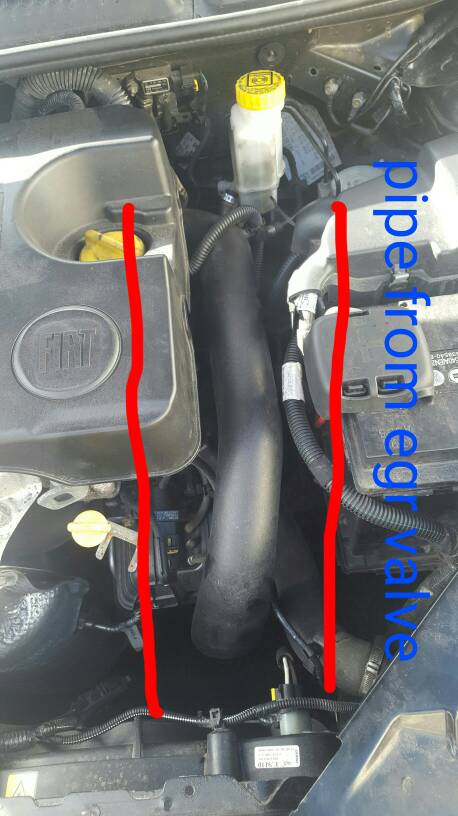

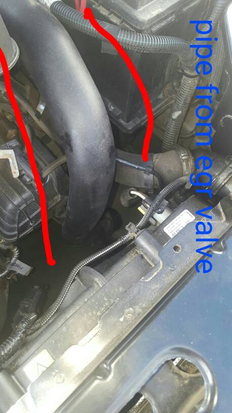

20161107_133917.jpeg20161107_133828.jpeg1478526280121.jpeg20161106_155209.jpeg20161106_155220.jpeg
Stuff like special pipes and hoses you might need to get from Fiat, or do some measuring of the old pipe, the inside diameter..etc, get some courage and do your own silicone pipe from ebay

Guess I was wrong then :-(

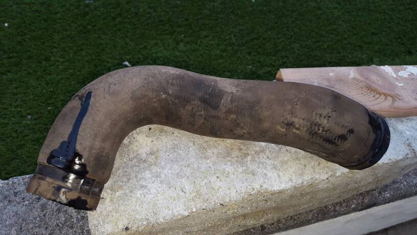

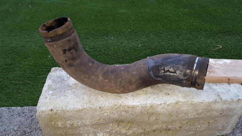

It was number 2 that I needed.. I only wanted the rubber pipe at the bottom but fiat would only sell the whole pipe..
£100 to fiat..
But now it's fixed ;-)
