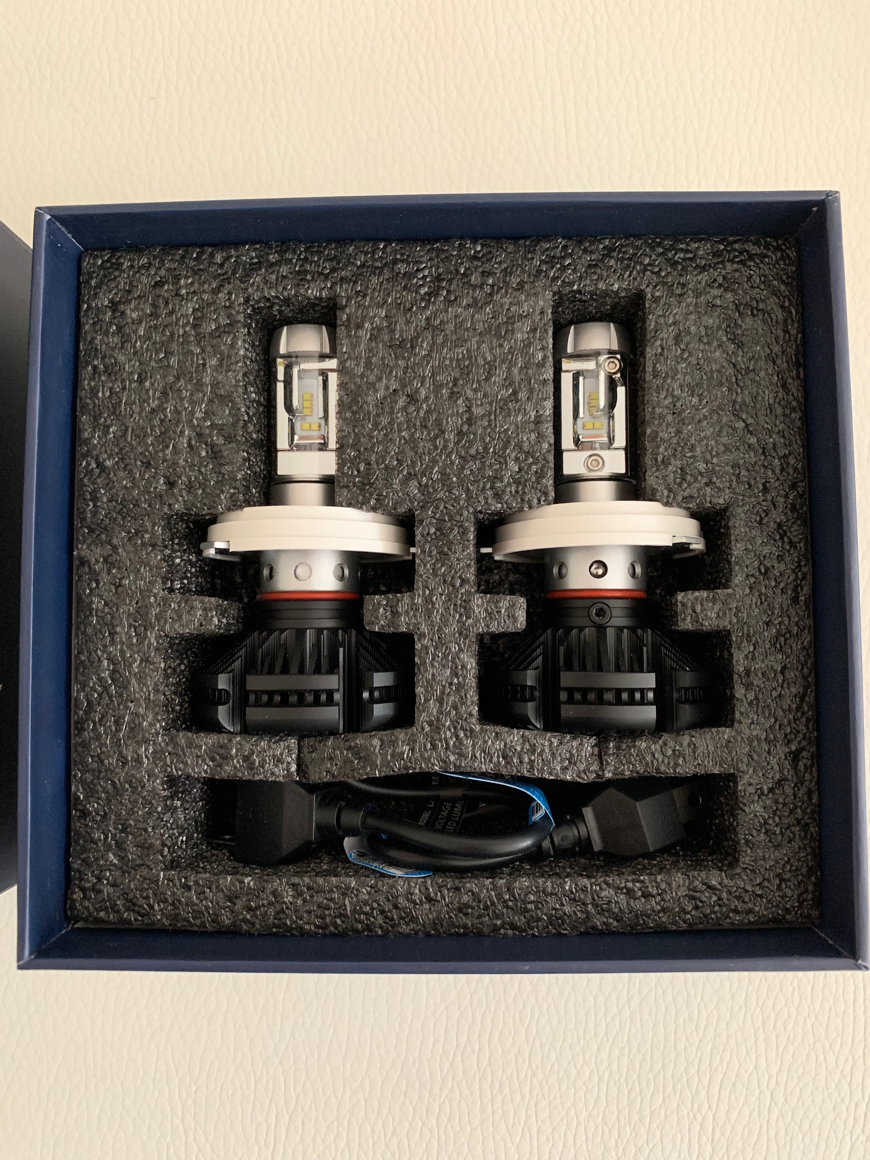

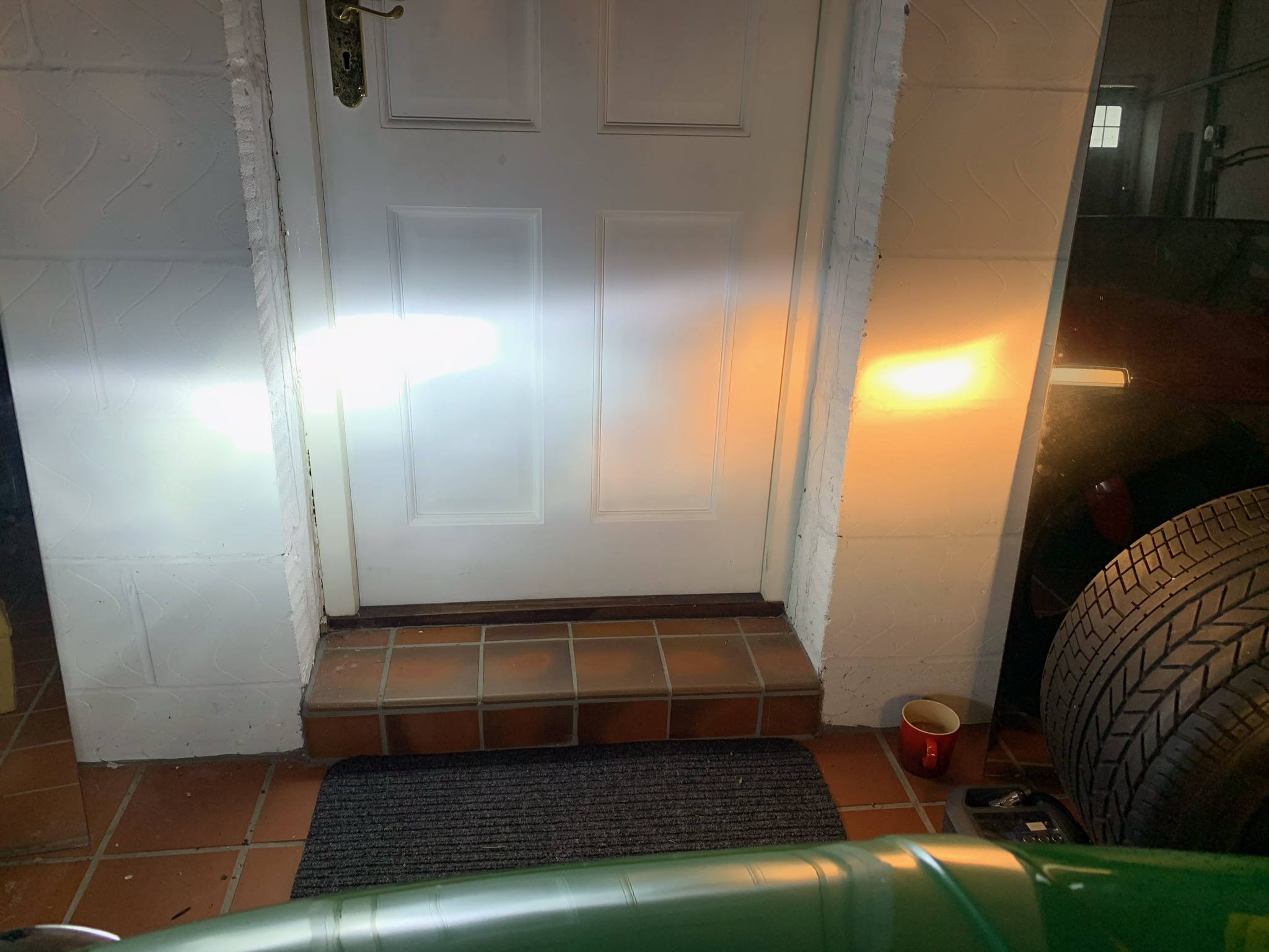

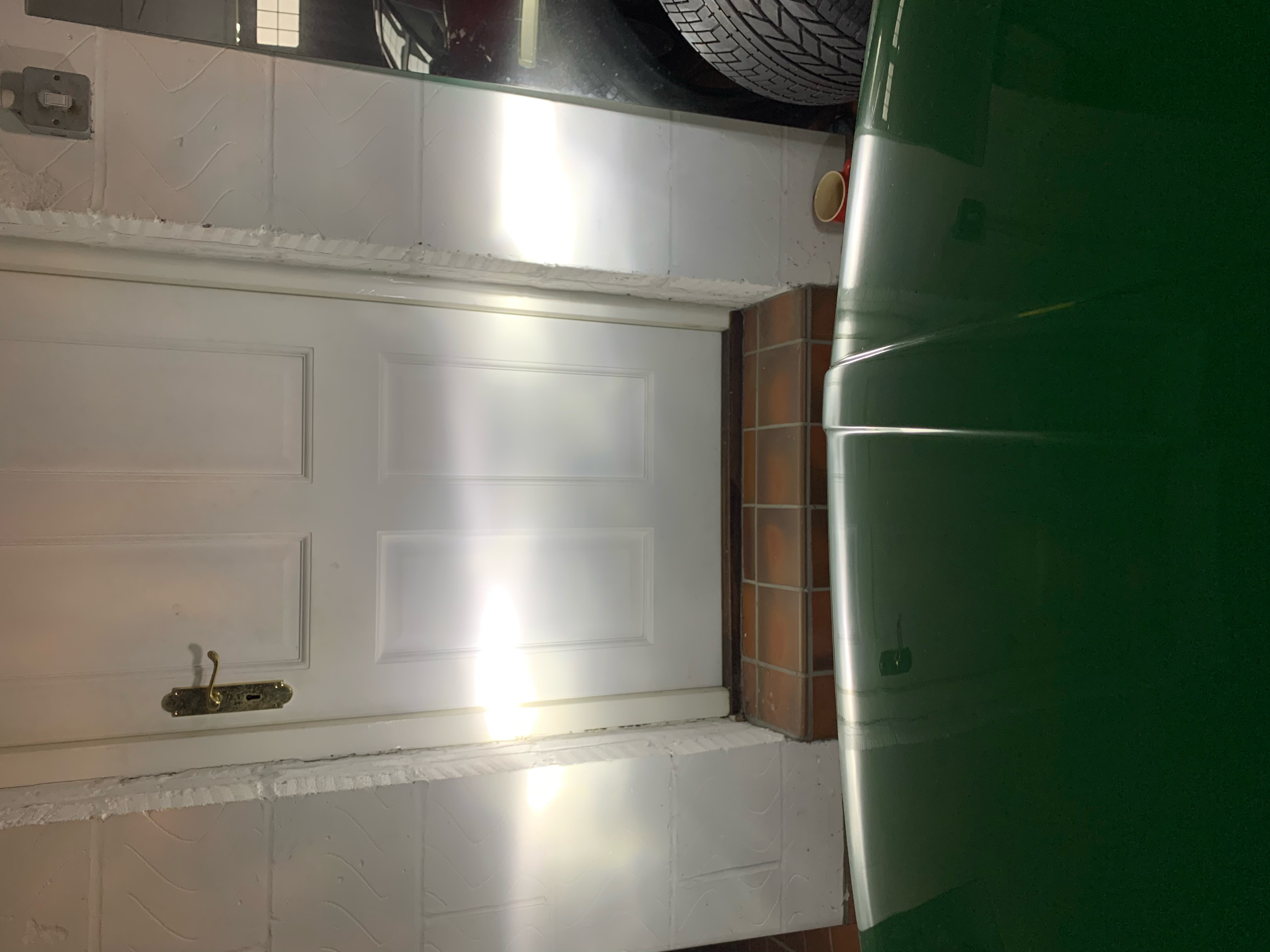

Another quick and easy upgrade I'll be doing this weekend. Plug n pray :D LED headlight bulbs.
Kick out about 6000lm, compared to 1200 ish for standard halogen. Will take some before and after amp measurements to see what the reduction in the draw is.
They have a small adapter fitted to ensure they fit the P45 style socket on the headlight. And plug into existing wiring. No relay / transformer required.
will report back.

Hi, I will fit first and see how they pan out. If all good, will advise where from. I would not wish to push a product without some prior testing ;-)
Please bear with me.
R
